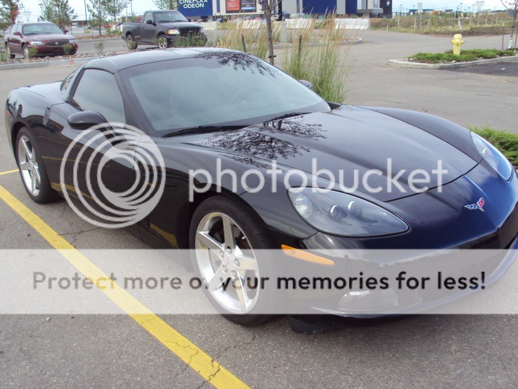

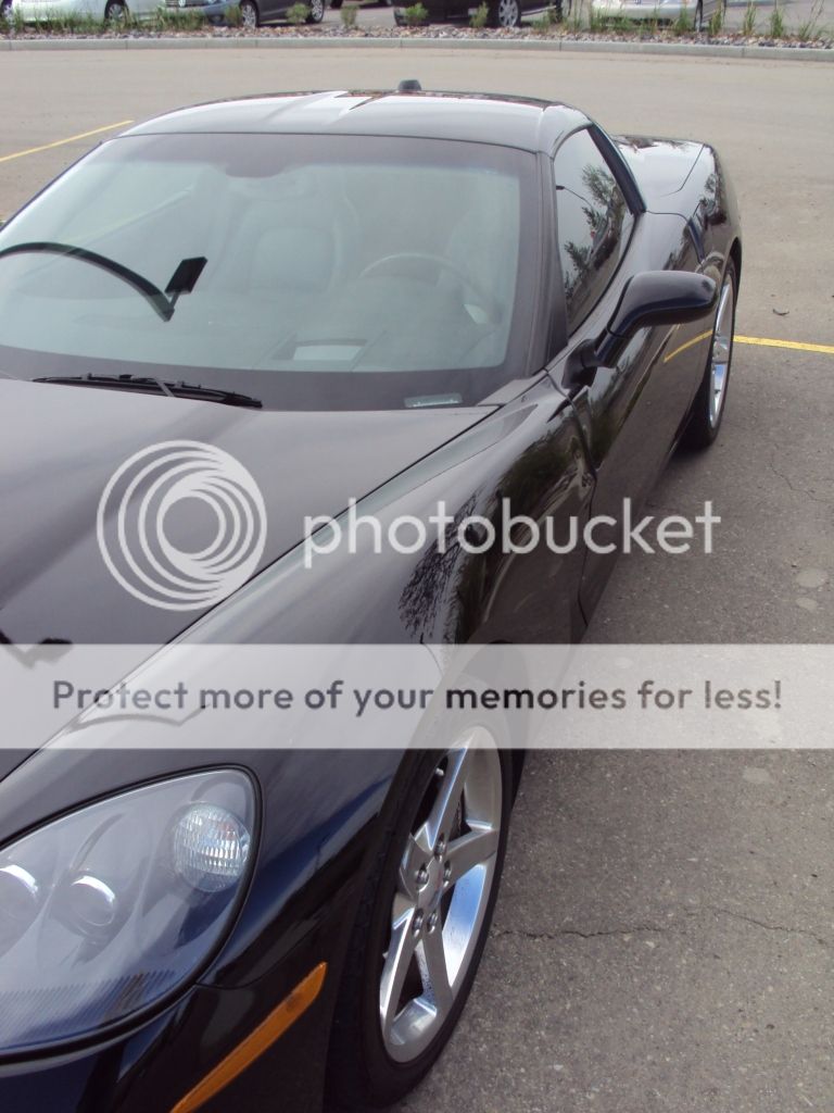

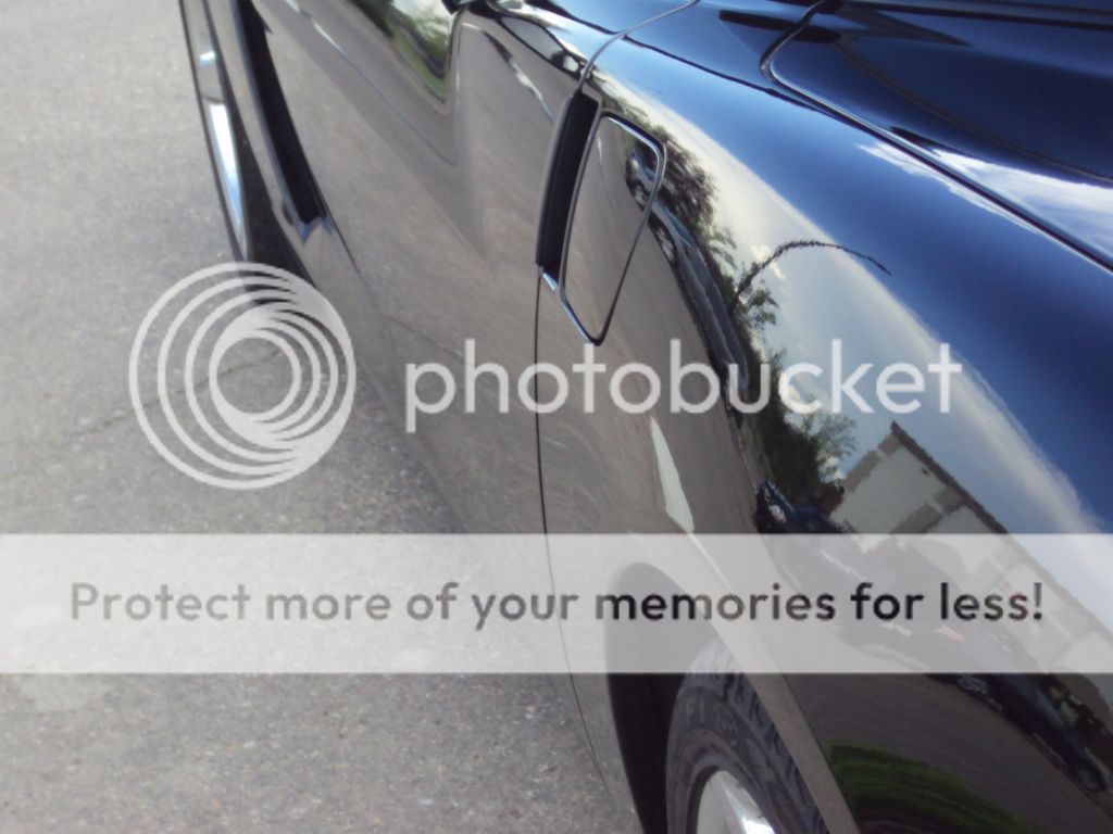

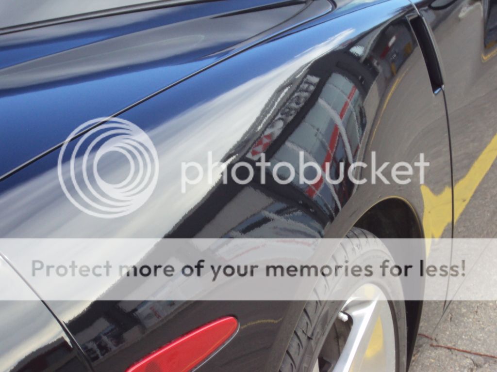

Morning came, and there was still some film on the car, so I took the same micofiber towel and started to buff everything out. Here's some pics of the end result.
The shadows of the tree made me think this worked well enough.
Hood looked like a mirror
As did the sides.

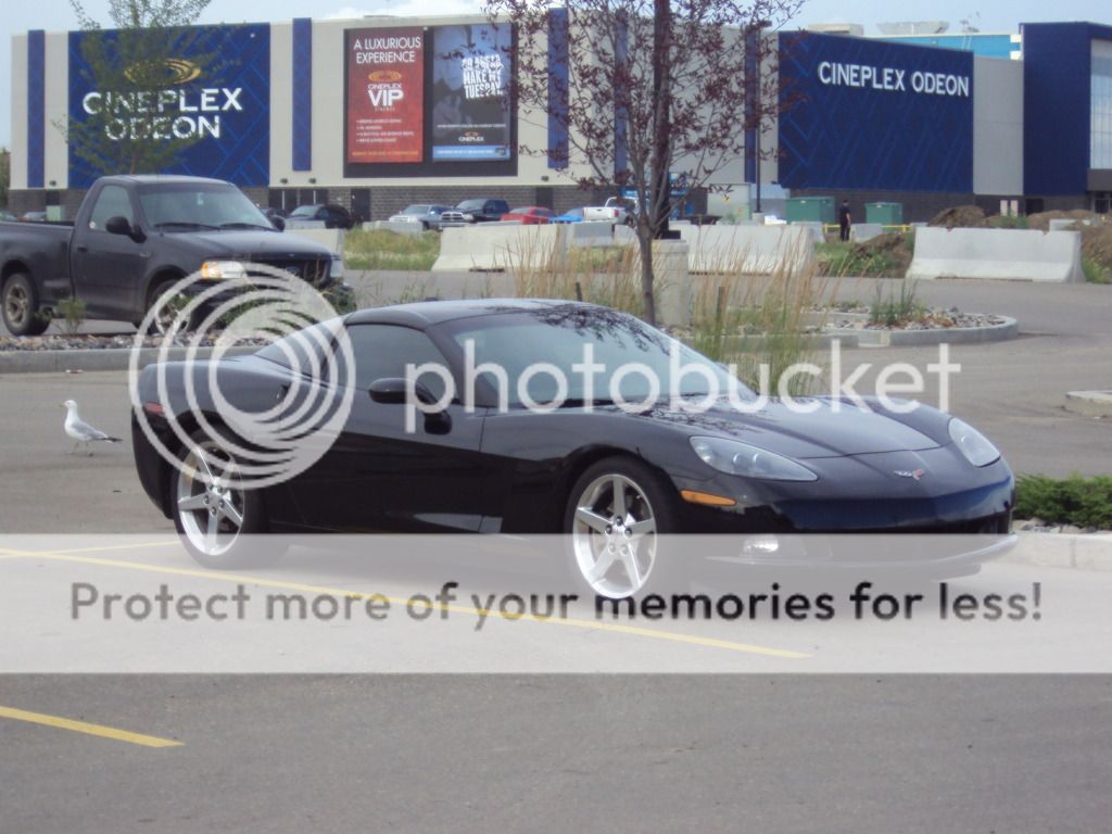

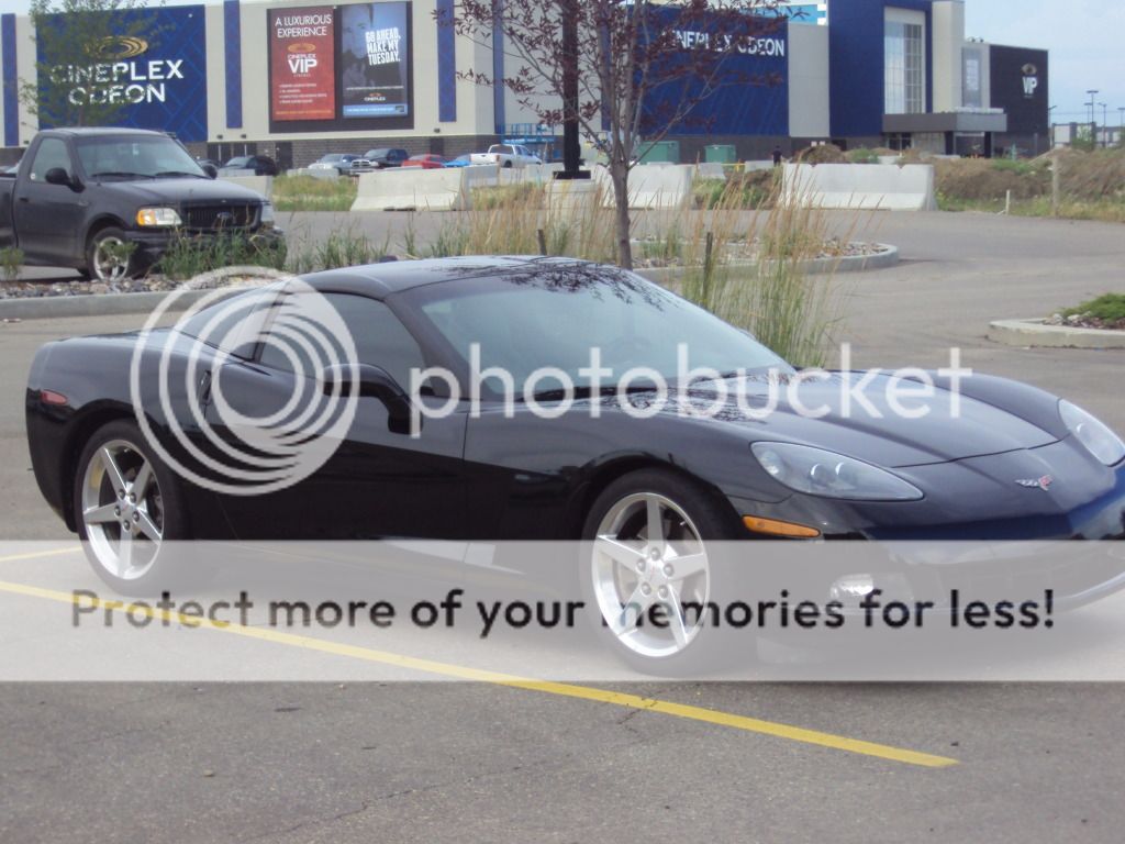

Yeah, it looks good, but does it look "wet"? You tell me.

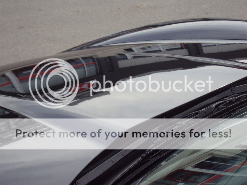

My reflection.
All in all the entire process took almost 5 hours, but I think I could do this again in 3.5 having done it once now. The paint was pretty good before, but it did help take some of the circles out, and polish it up a little.
There were a few scratches that I was hoping to "buff" out, but it didnt happen.
