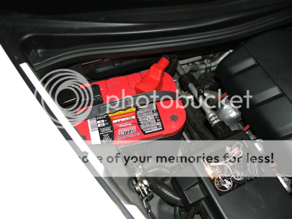

Picked mine up today after cruising down to Niagara area with Tony. Will install soon and post up pics and opinions.
