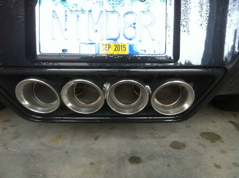

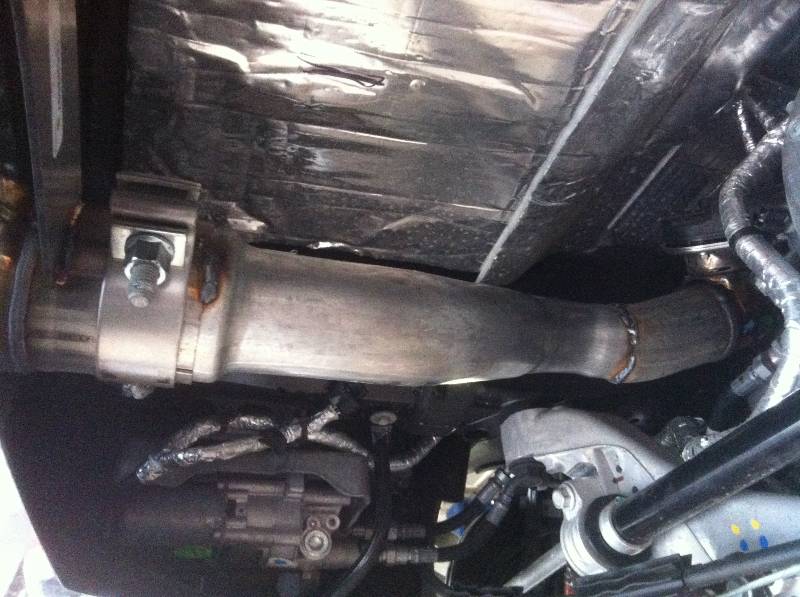

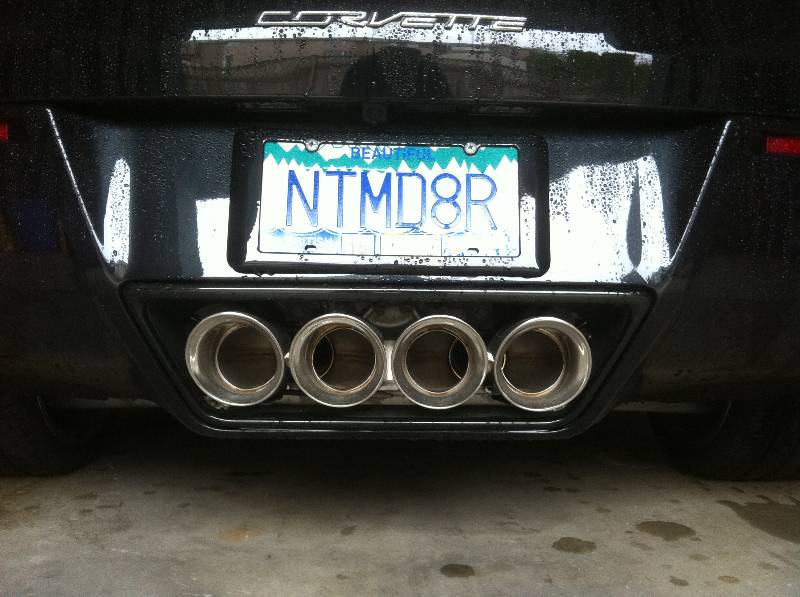

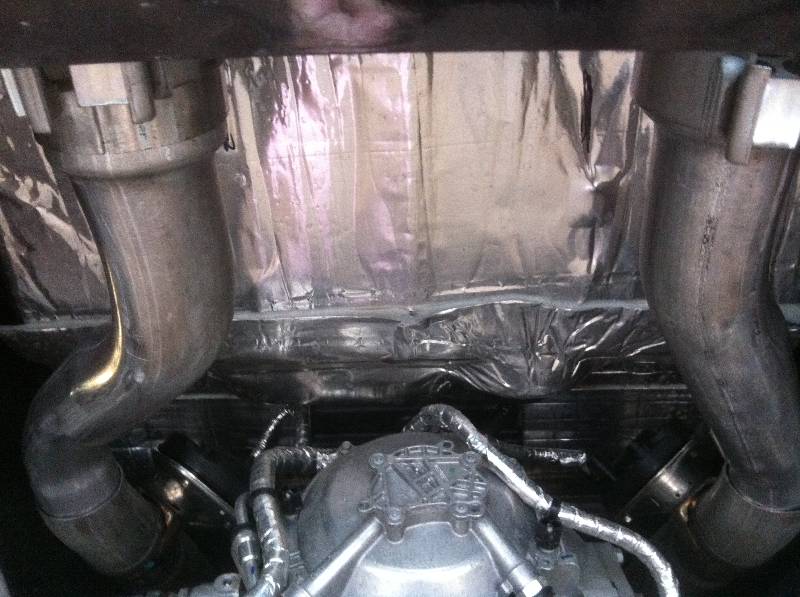

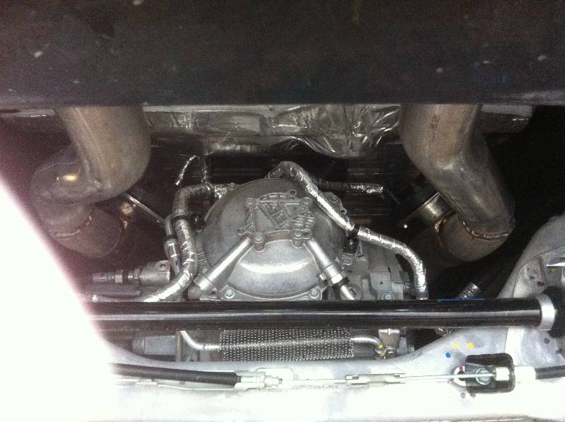

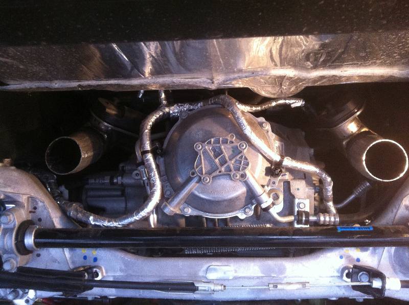

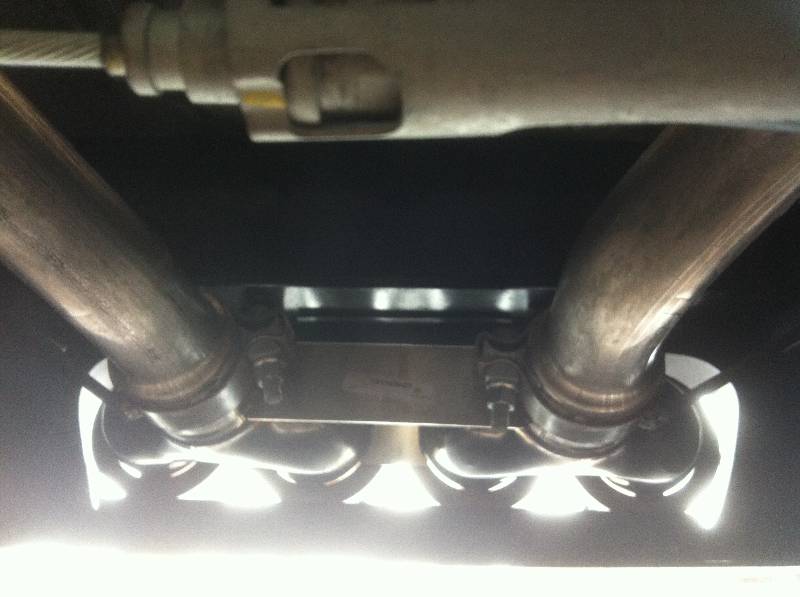

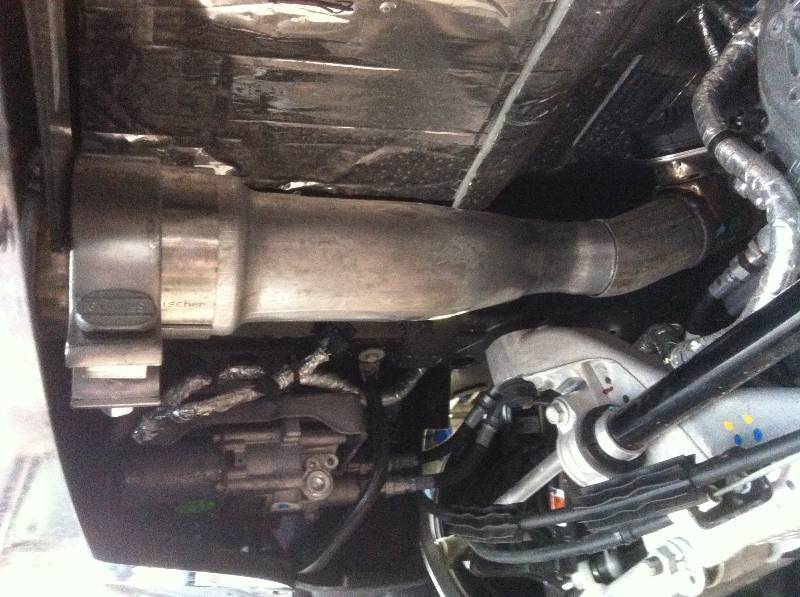

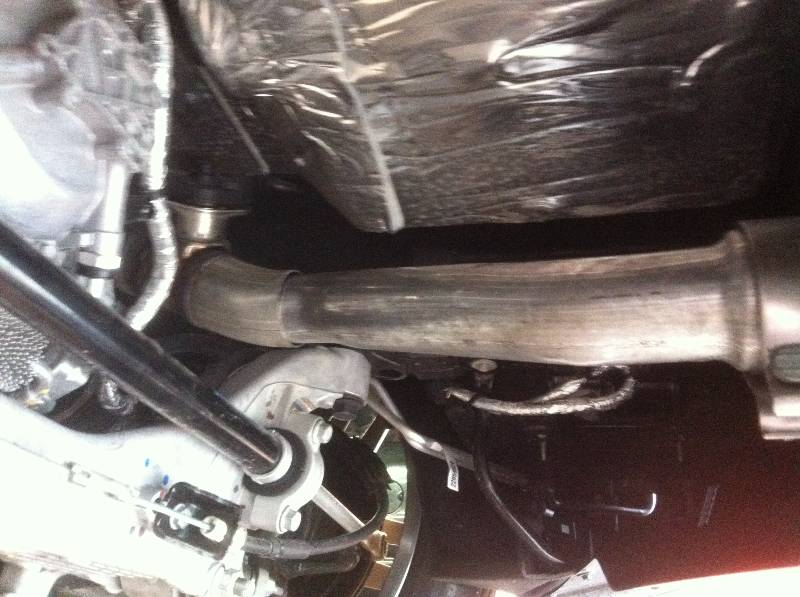

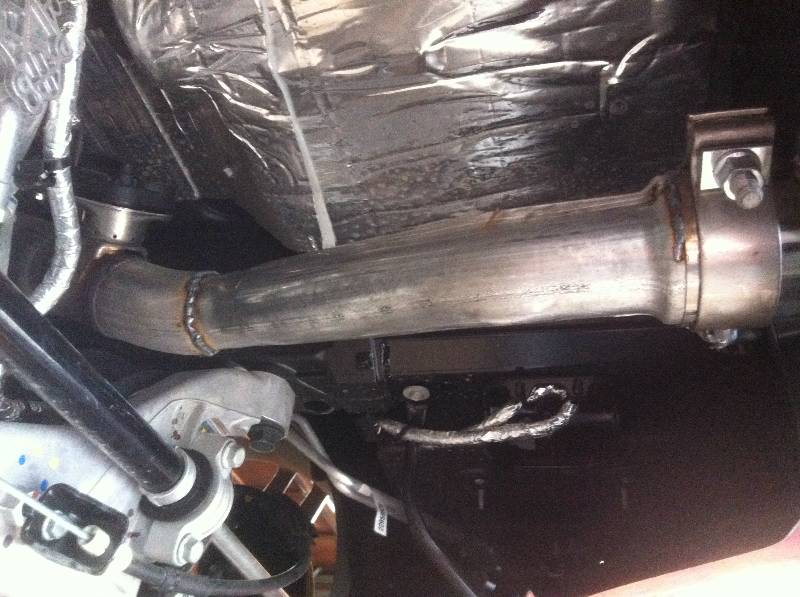

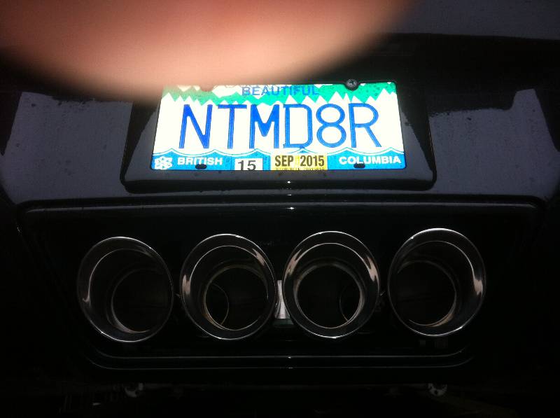

Like C7Jake, I have just deleted my mufflers, and replaced them
with straight pipes, adding Corsa tips.
Mine is a NPP car, but I think the removal would have been the same.
It took me 4 "shops" to find one that would do the job, but I found one this week, and we did it this morning.
WOW...... much louder (maybe 20%... and I did have the NPP fuse pulled),
and it now "barks", and deceleraton gurgles and barks nicely.
Here are a few shots of the install (it was raining here !!!!!!).
I'll try to get some sound video clips when the weather is better.
Both Mufflers removed
Dry fit Left Side
Dry fit Right Side
Dry fit Both
Dry fit Tips
Tips installed looking out the back
Right side installed
Left side installed
Both pipes done
Done
Done

I pulled fuse #42 on my 2015, no problems at all, just better sound. If you want quieter, select eco mode for v4.
If you have an M7, you will never go into eco-mode, unless you specifically make it.
If you have an A6 or A8, unfortunately, it will go into eco-mode when it wants to.
Of course, those eco-valves are just ahead of the mufflers, and you LEAVE them in, if removing the mufflers. Otherwise you WILL get a code.

...I've done alot of making up exhaust but who ever did that has done a nice job, they got a good bender obviuosly. Must sound wild . Should put " RUMBLE " on the licence plate.
