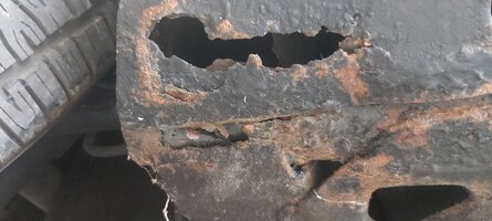

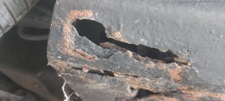

M Mike Holland I'm New Here Ontario Aug 28, 2024 2 0 VetteCoins 31 Car 1973 C3 Province ON Aug 28, 2024 #1 I need an opinion on some frame rot on a 73 I'm looking at. I don't know if it's a deal breaker or not.
gdh Regular You're 5 Jul 26, 2015 153 116 Ontario VetteCoins 2,865 Car 1972 Convertible Aug 28, 2024 #2 Mike Holland said: I need an opinion on some frame rot on a 73 I'm looking at. I don't know if it's a deal breaker or not. Click to expand... Unless you can do a swap on your own or want to do a complete frame/suspension upgrade I would run.
M Mike Holland I'm New Here Ontario Aug 28, 2024 2 0 VetteCoins 31 Car 1973 C3 Province ON Aug 28, 2024 #3 Mike Holland said: I need an opinion on some frame rot on a 73 I'm looking at. I don't know if it's a deal breaker or not. Click to expand... gdh said: Unless you can do a swap on your own or want to do a complete frame/suspension upgrade I would run. Click to expand... You don't think it can be patched? It's the only bad spot. Pass side rear floor part. The rest looks good and it's a chrome bumper. Attachments 20240828_152130.jpg 972.3 KB · Views: 0 20240828_152107.jpg 962.1 KB · Views: 0
