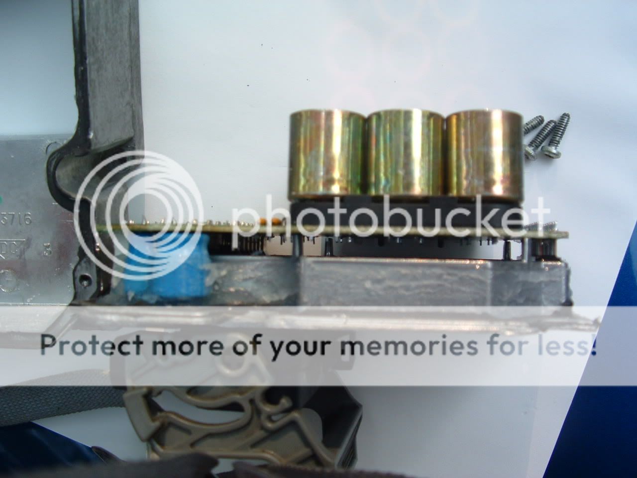

Hi. I own a 2000 C5. I get the 28 TCS - C1255 H - EBTCM Internal Malfunction. I have a Delphi D Model 09356961 with a Large M on it. My traction control and ABS light is on. Trying to find out if my module can be repaired because you need a wheel barrel full of money to replace it. It seems that the early C5's have the more expensive fixes than the 01 - 04's. Anybody out there have a good lead as to where I can start looking.

The EBCM repair is definitely a problem with C5s. I have a 2003 coupe 6 speed and had this problem with mine a couple of years ago. I had it repaired here in North Toronto. The company that repairs electronics on all kinds of vehicles is BBA Reman. They have repair centre's all over the world including several across Canada. Their website is bba-reman.com and they are located at 467 Edgeley Blvd, Concord, Ontario here in the Toronto area. It cost me $250.00 and they guarantee the repair for as long as you own the car. Mine has been working perfectly ever since the repair.
Good luck. By the way you can still drive your car with the module removed you just don't have any traction control, stability control or ABS. Just like old school.

I am the original author of the EBCM repair procedure using the Potter & Brumfield relay about 12 years ago. My post was deleted by another forum in the US and rewritten.
So is what your saying you know how to repair the 2000 & earlier EBCM's and are you willing to share? I will look online to see what the Potter & Brumfield relay is all about. Something else to investigate.
