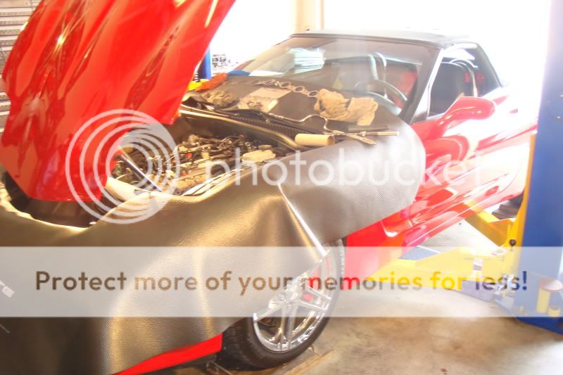

A few pictures .
Here we go
The goodies all ready to be installed
The tear down complete we see the carbon build up on the pistons . No worries as E.C.P will make it look right again.
Ah that looks much better ,all clean again.
The PRC heads with the Harlen Sharp roller rockers
The video . Rob and I worked untill 4 am to finish this for Barry.
Thanks again for choosing E.C.P Barry.
