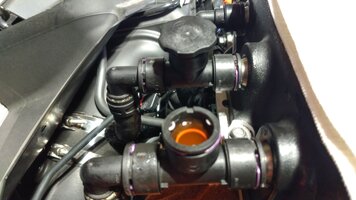

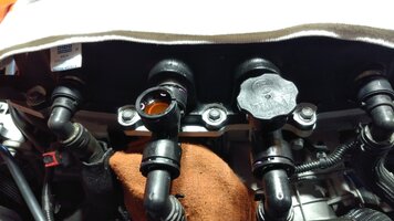

This aftn I decided to do both intercooler systems again on my ZR1. It was pretty well bled the first time I did it but because of the "issue" I had when I first hooked up everything (discussed in the video) I wanted to make sure things were set up and worked properly right from the get go.
So all the stuff went into the garage and I got to work, this time grounding the electronics properly got everything working perfectly the instant I turned on the bleeder and vacuum pump. The majority of the air was removed previously but this time I let each side run for 15-20 mins and it got a tiny bit more air out of each side. Basically whereas I had huge air pockets coming out of both systems the first time I did this, this time the air being removed from the system was more like dime/nickel size pockets and still weren't that many of these coin size air pockets coming out of my dual CAC systems. 2 pics I took after each side was done shown below, the first time I opened the plug on the driver side system you could not see coolant at all, after I did this side the first time the coolant was at the bottom of the opening and this time redoing it it's right up to the top. I did a better job on the pass. side previously so this time the level after I was done was only slightly higher than the first time doing it.
Still glad I redid both sides again, now I'm confident 99.9% of the air is removed (if not ALL the air).
