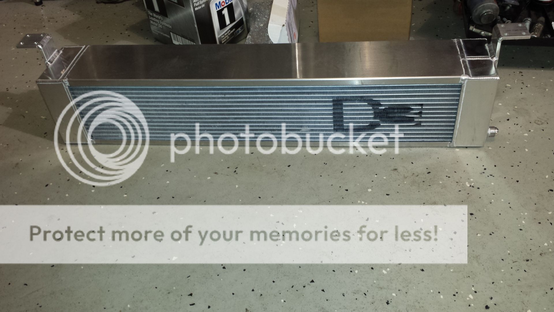

Front end off to install the D3 massive intercooler and HV pump
This thing is wicked :
