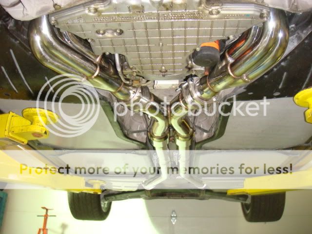

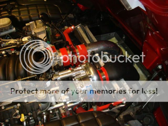

Here are a few from Dangerous Dan Street Killer Build .\
The details :
2000 Mag Red A4 auto
The build:
A&A Supercharger V3 with a 3" pulley
Innovators West 8 rib pulleys
LT headers /high flow cats & x-pipe
C5 Z06 Ti exhaust
C5 Z06 rear diff with 3:73's
Line Loc
B&M trans cooler
ACI front lip & skirts
Z06 brake ducts
A few of the goodies :D
