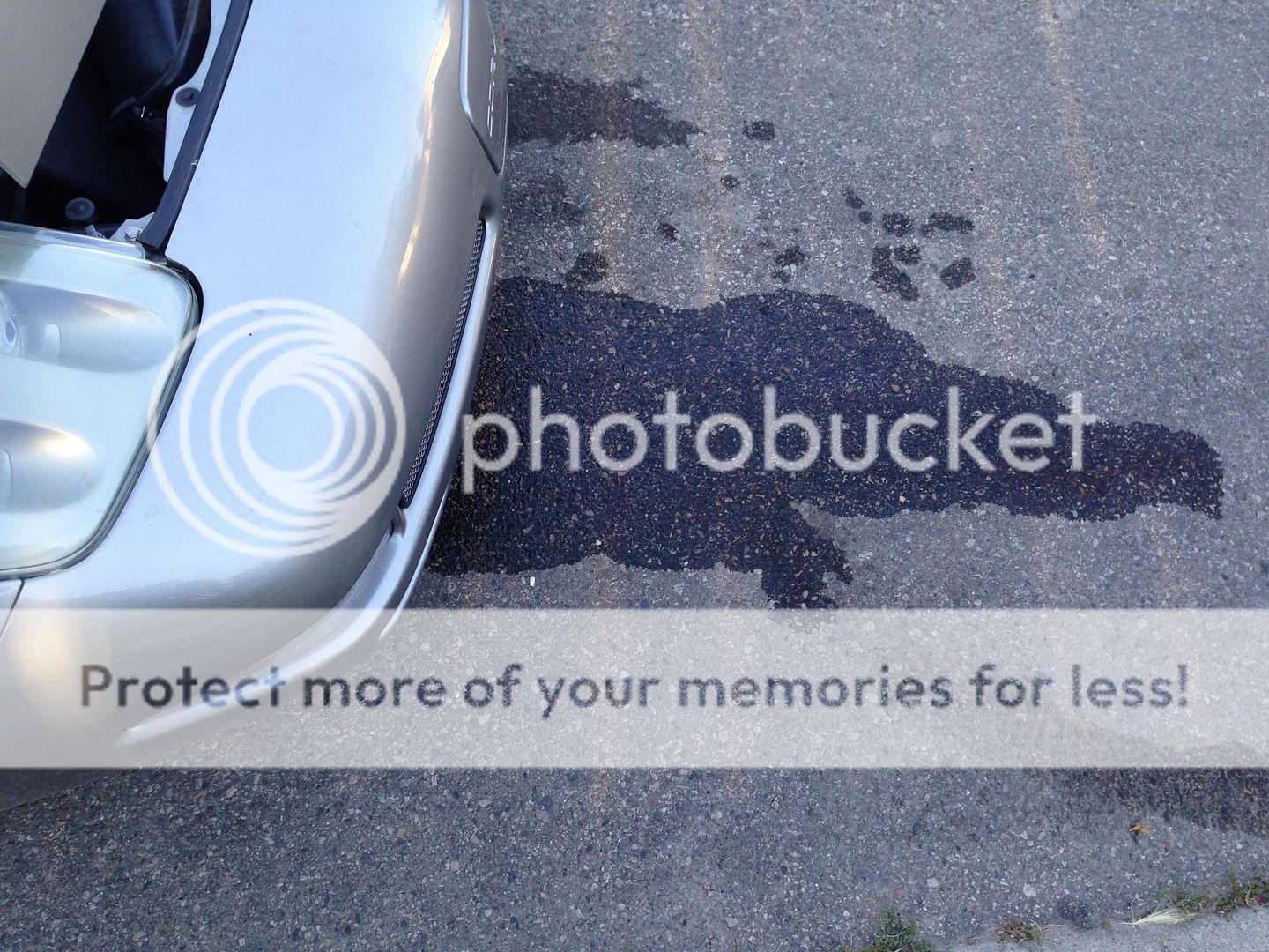

Well, if no longer being able to replace the SWPS in the ol girl wasn't enough, I came outside yesterday to find this:
The puddle on the drivers side of the car is actually an old stain on the road. I just parked in the wrong spot.

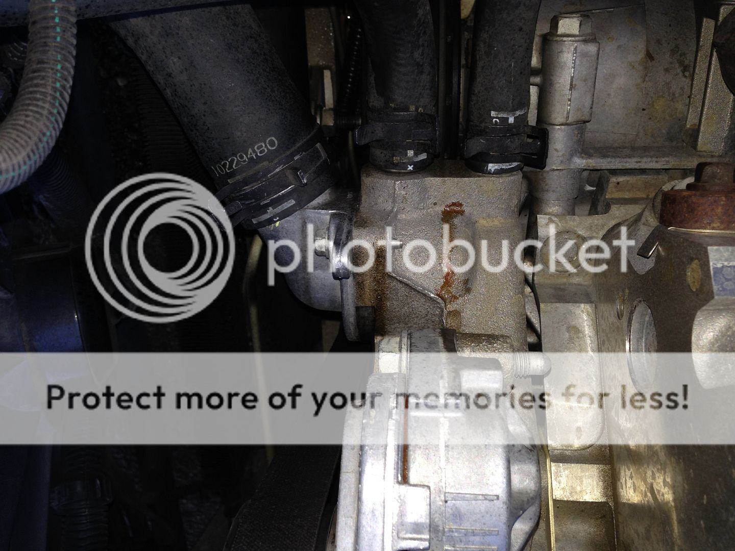

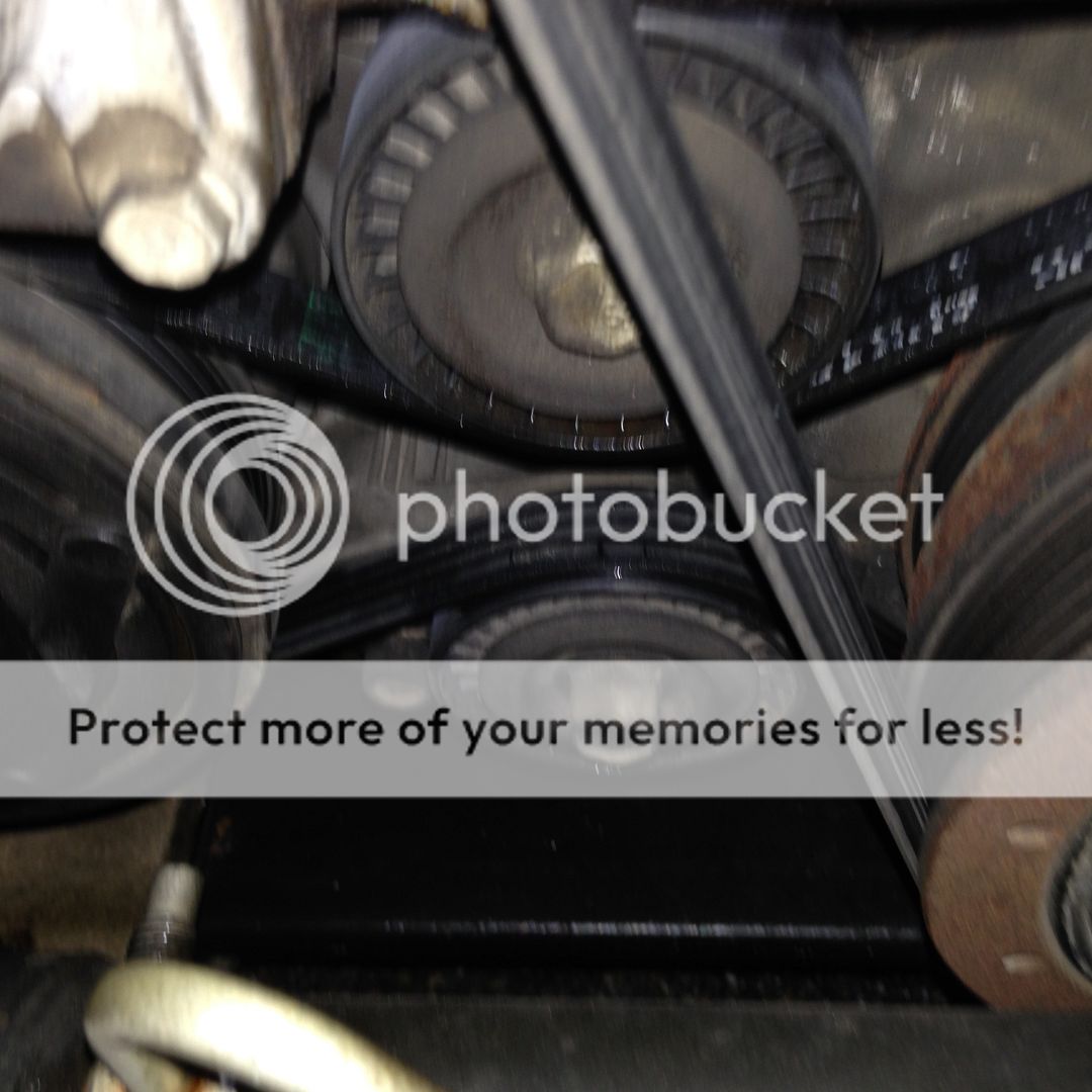

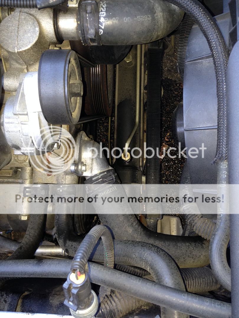

Anyway, the rad looks good. All hoses look good. I can't find evidence anywhere except that the one side of my power steering rack is wet, that is the only wet thing I can see from the top. There is light spray on different parts but nothing wet besides the rack. There is a lot of coolant on the subframe under the car and it looks wet on the lower control arm. So the only thing I can think of is water pump? The weird thing is I just can't see anything from the top that would indicate it would be dumping that much coolant. Very crazy.
Stuck the camera down in front of the engine and snapped a few photos. Hopefully someone see's something.

Hi Riley , the earlier C5's came with paper gaskets on the water pump that do go bad eventually . I do suspect from those pictures that this is your problem .
Its not too bad of a job to change them out ,and it can be done by a novice in around 2 hours .
When replacing the gaskets , make sure that you purchase the upgraded GM aluminum and rubber ones , and coat the bolts with a dab of silicone on the threads when you re-install the pump .
If by chance your Vette came with the new style gaskets , they too can fail as the rubber on the edges distorts over time .
