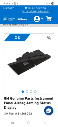

Would anyone know if u can remove the hazard switch (triangular switch beside the middle vent above the NAV screen) without needing to pull the dash carbon fibre instrument surround part?

This is what I need to install Screenshot_20250707_172948_Chrome.webpThis is the existing20250703_201554 (1).webp

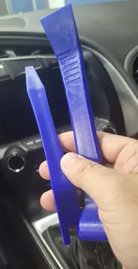

Great news!!! I got it out from the front of dashboard by poping it out with trim tools👌👍:)
