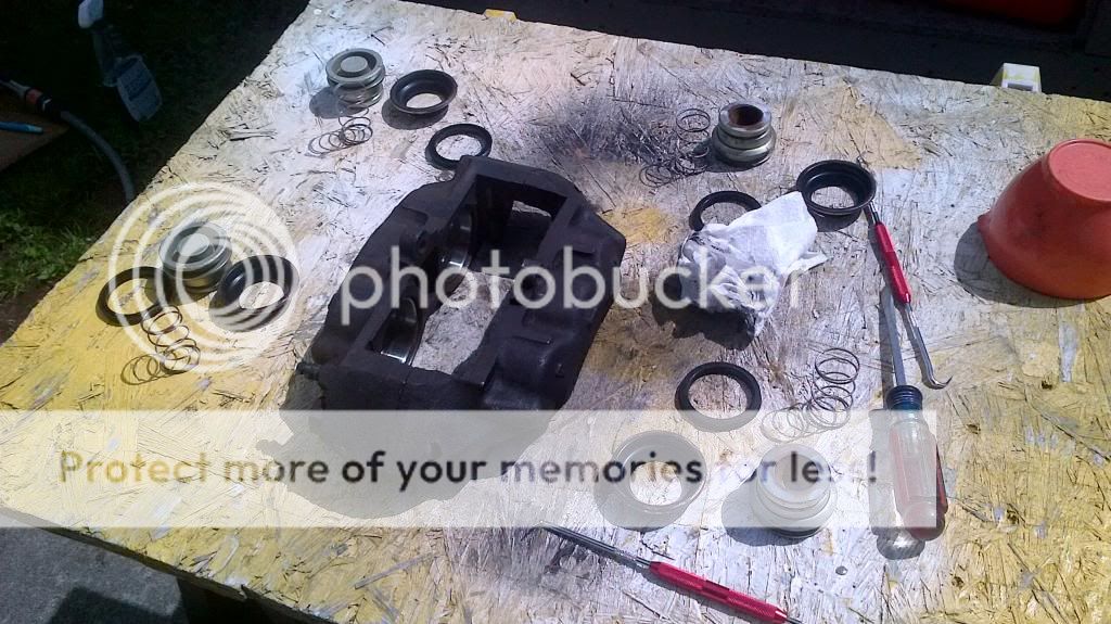

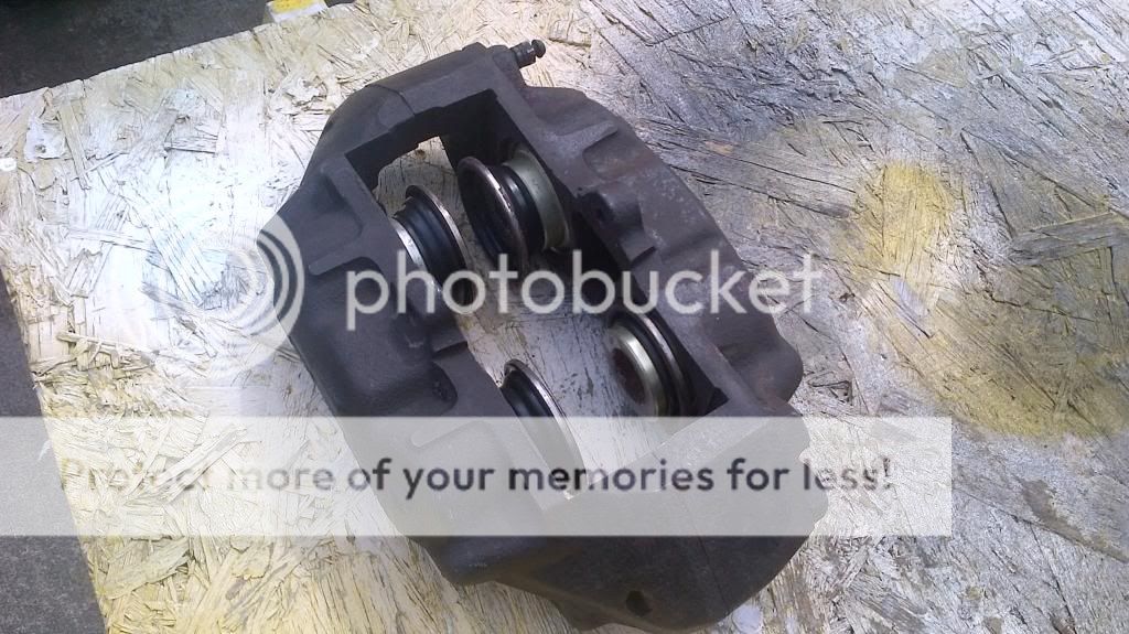

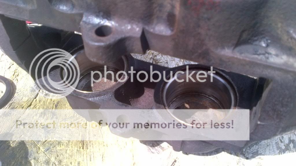

My '75 has a leaking brake caliper. The car has been sitting for a couple of years. I recently rebuilt the motor and started taking the car around the neighbourhood. It is pulling to one side. It appears the left/front caliper is wet!
I've looked into replacement calipers..new vs rebuilt..core charge, etc.
I've decided to rebuild my calipers myself. I have a spare used right/front caliper that I took apart to see what's involved. I checked out some of the kits on-line and also found some rebuild videos with hints and tips.. I want to go with the upgrade 'O'ring seals vs the original lip seals. This requires new pistons.
