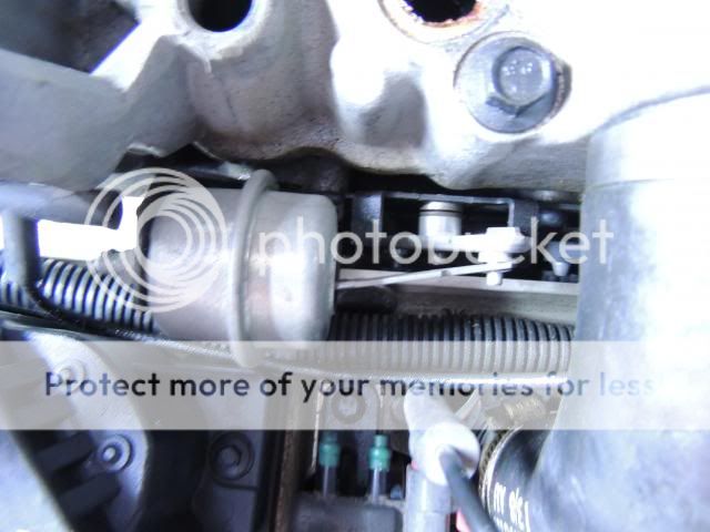

Finally I decided to pull the starter to replace the solenoid contacts. For those of you that are not familiar with the LT5 DOHC engine in the ZR-1, the starter is located in the center of the Vee underneath all of the Air Intake Plenum.
![010-3.jpg](/proxy.php?image=http%3A%2F%2Fi145.photobucket.com%2Falbums%2Fr203%2FBearlyFlying%2F010-3.jpg&hash=ceba86095bb19b47530a5bec978cceab)

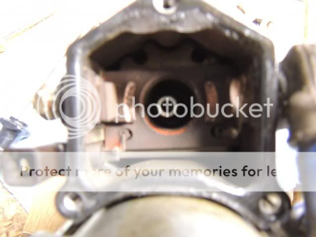

I started tearing apart the engine on June 15th. Found the problem. (a $3.00 part)
![027-1_zps7e65ac92.jpg](/proxy.php?image=http%3A%2F%2Fi145.photobucket.com%2Falbums%2Fr203%2FBearlyFlying%2F027-1_zps7e65ac92.jpg&hash=70f6c9ac3b224a2c2926d7e8a50ff9f5)

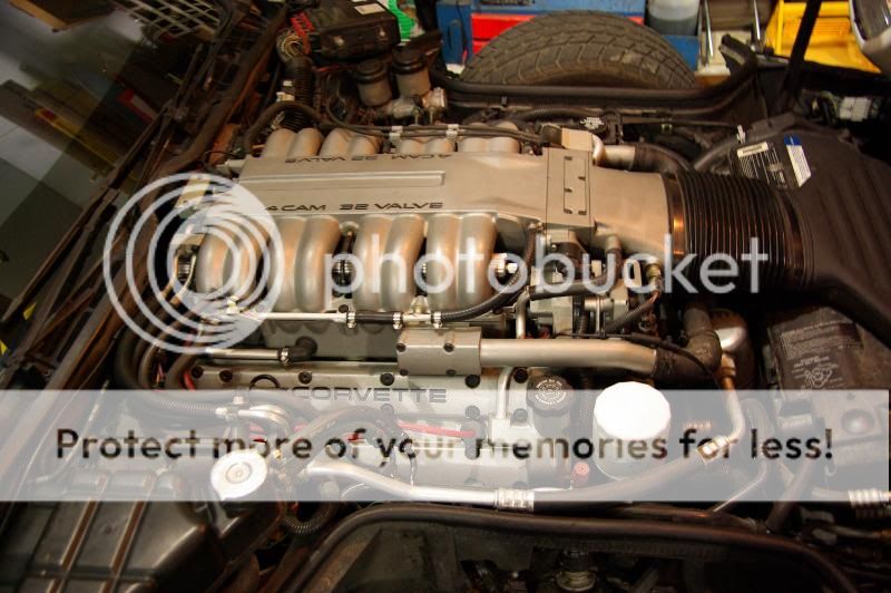

The ZR-1's had a few area's that could be improved upon, the intake ports were relatively small and the fuel injectors were designed before the world of ethanol fuels which would cause the mild steel pintels to rust and the cause the injector coil windings to degrade and short circuit.
Being as I already had all of that removed, I shipped Plenum and Injector Housings off to a ZR-1 Specialty Guy in Illinois to have them ported and Powder Coated. New injectors, gaskets and a S.S. bolt kit from Jerry's Gaskets.
The LT5 has a vacuum operated Secondary Throttle system that opens a set of butterfly valves in the secondary intake ports and activates the secondary fuel injectors. (16 fuel injectors in total) A common modification is to remove the secondary throttles and run all of the injectors full time. So I removed the secondary system and sent the chip out to be reprogrammed.
![020-1_zps1a65c048.jpg](/proxy.php?image=http%3A%2F%2Fi145.photobucket.com%2Falbums%2Fr203%2FBearlyFlying%2F020-1_zps1a65c048.jpg&hash=8ac6bbf44f2001869331c0a326b3c1ef)

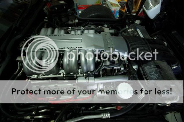

Got everything buttoned up, looking pretty good,
![IMGP3907_zps01a585f4.jpg](/proxy.php?image=http%3A%2F%2Fi145.photobucket.com%2Falbums%2Fr203%2FBearlyFlying%2FIMGP3907_zps01a585f4.jpg&hash=10e3795882ea8dc5c9910d26c845a3d4)
Fired it up, running sweet, no codes, leaks or problems.....
