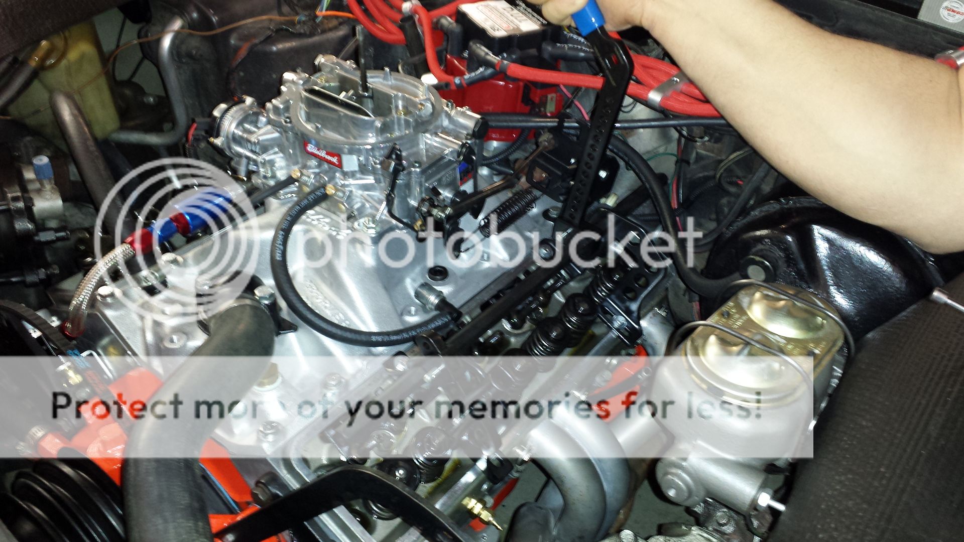

Great pics Wayne. Looks like they're putting my headers on after the cam break in is over. :)

Yup , headers plus putting the springs together again . Just a little of knowledge for you all . The heads had triple springs , in order to break the cam in you have to remove the 2 sets of inner springs or else there is too much spring pressure .
Also helps to have the right tools too:
This is why we get the big bucks :rofl:

Triple springs? Sounds like overkill. :confused:
Should be good to 6000 rpm with that cam and valve train. :eek:
Good catch Manny. You guys are very thorough.
