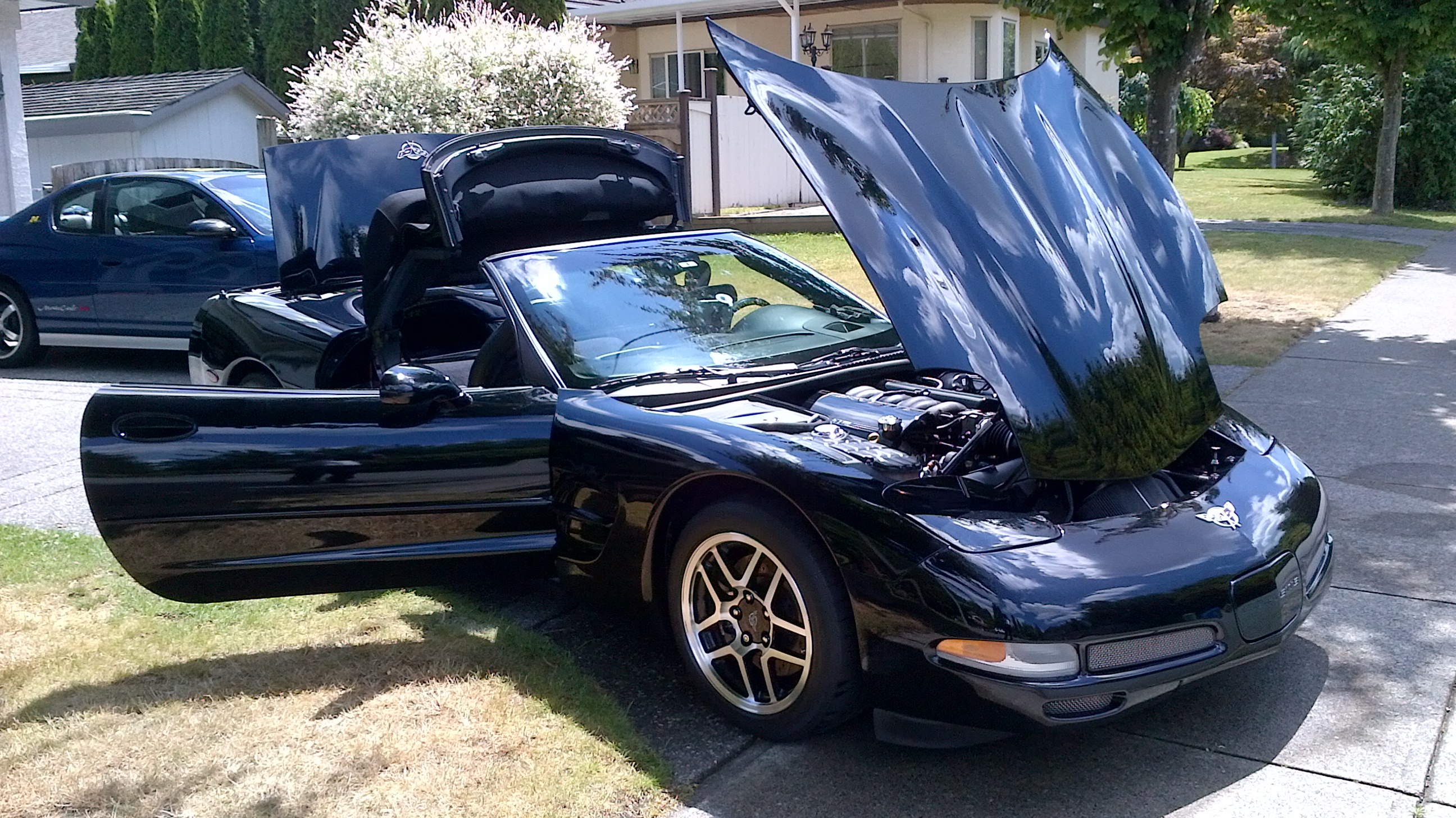

Heres a quick shot of a 2014 Mustang GT Hood I worked on after using Menzerna MC2400. I followed up with an IPA (Diluted Isopropyl Alchohol) wipe down 1:10
so what was the combination of products you used this time?
Sorry, I'm late to reply. I used the following:
Chemical Guys Citrus Wash and Gloss. (You need a good cleaner wash to get any old products off, before starting and this is the chit).
Chemical Guys Clay Bar (I really don't think there's much of a difference in this and Maguire's)
Menzerna Medium Cut 2 Compound. ( I did have to use a hard cut for the deeper scratches and swirls).
Menzerna Super Finish Plus finishing polish)
Swissvax Scuderia Wax. (Very expensive but it seems like even after 5 coats, they just keep getting deeper and deeper) I LOVE this stuff!!
I will likely try some new products, that I'm told are hitting the market in 2018, but to date this stuff is my favorite.
Funny thing about the tires...........DON'T, I repeat DON'T ever use AutoGlym Tire dressing!! These tires looked amazing the night before these pics were taken, but didn't last the day! I normally brag about Autoglym stuff, and like a lot of their products, just not the tire crap. Anyway, I'll get more pics (with the tires done lol, and some inside a garage because they look way better inside, as far as reflection goes).
Toxic, that's really, really impressive! I really like the Manzerna products. I get all my supplies and tips from Auto Obsessed in Edmonton. They are pricey too, but you can't put a price on their experience, so as long as they are willing to share their knowledge, I'll continue to purchase my supplies from them.
Toxix..
I wish I lived closer to you.. I need help with my black cars.
Graham
Could this be the same Graham (nascar03) that I know... and have visited.... and have seen his "black" Corvettes...and have lost my balance and fell into their shine while gazing upon the reflections of the world around them.... and just recently have climbed my way out of the bottomless depths of their paint .. ?.... naw.... Couldn't be the same guy... Couldn't have been this car's owner pleading for help.... :rolleyes:
