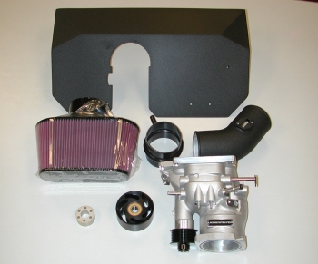

Just an update all fixed up and ready to go tranny rebuilt and Lingenfelter 710+ kit installed by Dasilva Motorsports ,Manny and the guys there did a fantastic job . It's scary fast now gonna have a blast with her .
Kevin , thank you so much for letting Dasilva Motorsports fix and improve your ZR1 .
These ZR1's respond so well to a few simple mods
Thanks Manny I can't believe the responsiveness to the throttle now , it is just scary fast . As well I could never hear the supercharger before it's something else . Up next headers and exhaust

What pulley was install on the LPE snout? 2.6 or 2.3? . My waranty will expire in 2 years, the 710 kit and supercharger cooling upgrade will be the next moves. For now I am only doing aesthetic mods to keep my waranty valid.
It's a 2.6
