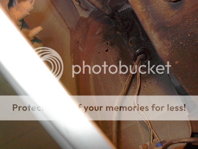

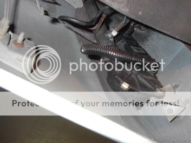

here are pics of my 82 , should be the same as your car. Bolted on just behind the rear wheel and nothing going up except for the chrome nut on top of the fender that turns into the tube. The wiring is clear to see where it comes out from and plugs into the motor.

I'm gonna look closer for these wires. Thanks a whole bunch for all the time and effort you guys are putting into helping me!
