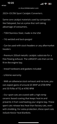

I had 2M sport cats on my C8 stingray and really like the added throaty sound.
Taking the plunge for the c8 Z06.
Any experience out there with these or others on the z06? 2M in particular.
Claiming 25hp (didn’t notice much difference on the old car)

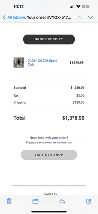

Here’s my completed order - final price shipped to Alberta - will report back.
