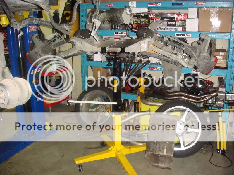

My good buddy Wild Willy dropped off his 01 C5 for a new clutch last night. Rob and I were feeling pretty good so we got on the install right away at 6pm and at 10pm everything was out and ready for the new Luk Pro Gold clutch and flywheel kit . We also have a nice new pilot bearing and a new clutch slave .
The new disk and flywheel
The new pressure plate and slave
Should have it together later today :D

Was a lightened flywheel added with the clutch or a stock weight?
Also Manny does the whole front end get dropped again to replace the clutch?

No, this was a pretty much stock LS7 type clutch and flywheel
For the clutch install , just everything from the rear back comes out , including the headers
