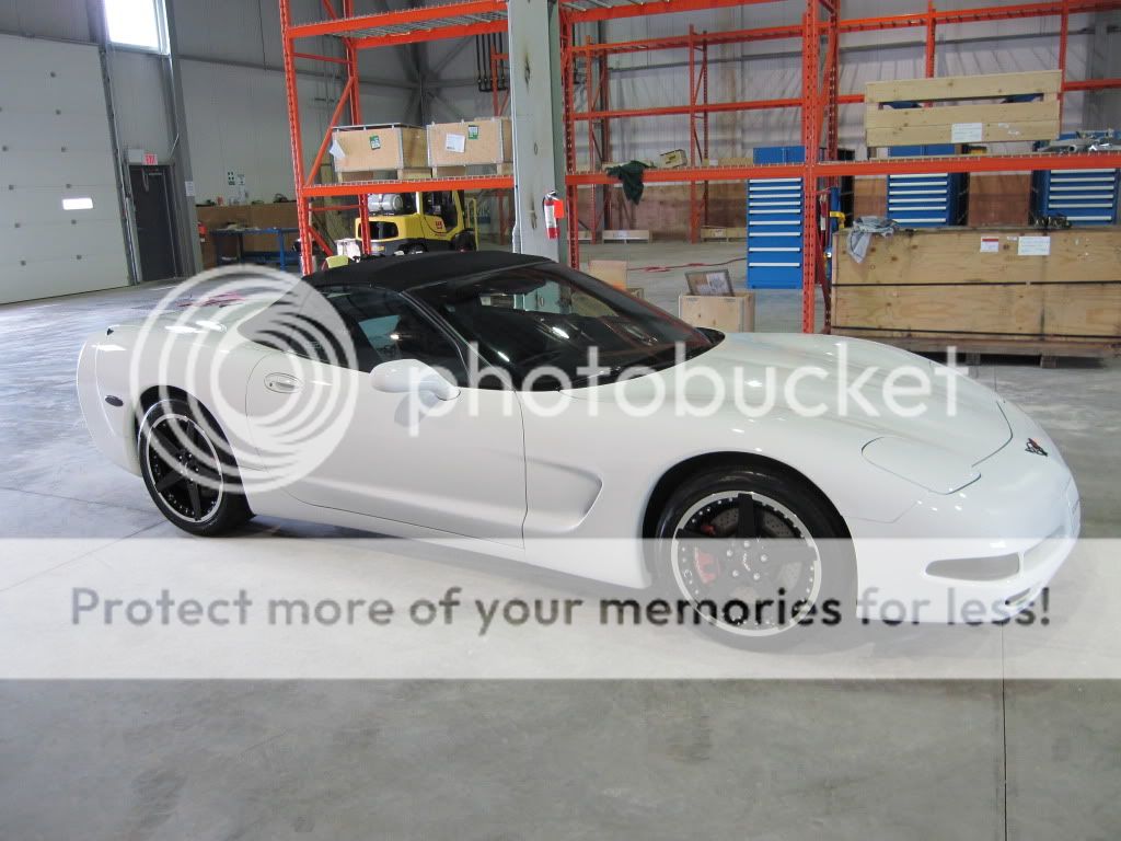

CCW is a stand company , that make a fantastic product . They ship to Canada quite often . There are plenty of people up here that have dealt with them. The ideal wheel wheel set-up for your C5 is a 19 / 19 CCW :
19x9.5 front and 19x11.5 rear .This allows you to run a 275/35/19 front and a 305/30-35/19 rear .
The only thing that will upset the handling is if you do not use a proper stagger . Now CCW's are polished so will require some work to keep shinny . Another good option would be Ace Slick Wheels or West Coast Corvette's has their own brand. Again these companies ship to Canada on a regular basis . The dollar at par means great deal s for us :canada:
Take from experience , buy a quality wheel and up size . I have gone through quite a few different wheels and my CCW's are forsure my favorite .
I run CCW 505a's 19x10 front and 19x11.5 rear .Tires are 275/35/19 up front and 305/35/19 rears... Manny is correct in that they require some effort to keep them looking good, but they are one of the best looking wheels for C5's IMHO.... :coolgleam:
