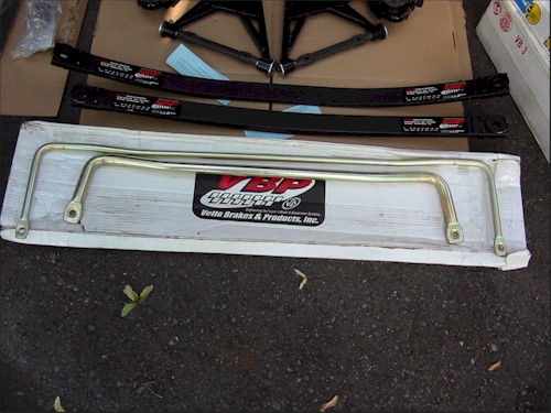

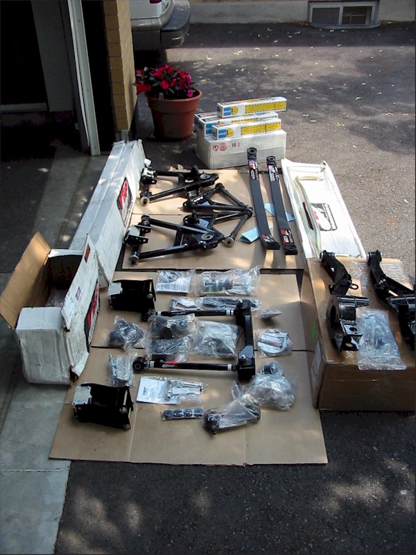

Anyway, I think you'd be surprised how well my '67 handles, even with 502 inches of BBC under the hood. Weight management played a role.

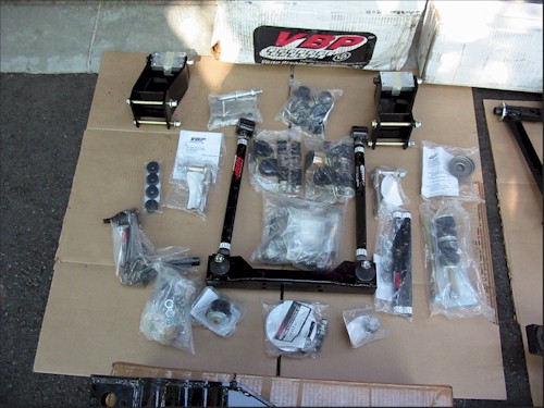

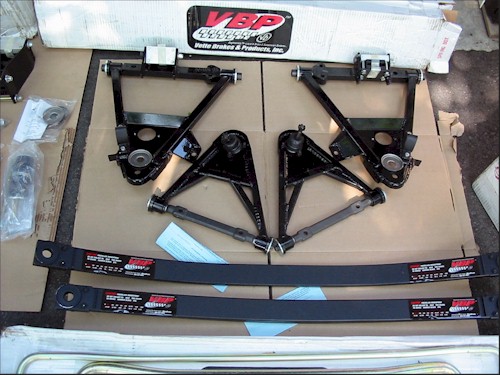

Complete Performance Plus suspension which includes new-design, lighter and stronger upper and lower A-arms, monoleaf springs front and rear, and much more; also used a spreader bar between front shock towers, aluminum water pump, aluminum heads, aluminum intake, headers (in place of cast iron manifolds, exhaust system and mufflers), aluminum rad, twin electric fans (in place of heavy old clutch fan).
The much improved handling, acceleration and braking was also helped by almost twice the rubber width front and rear.
The overall weight-savings is well in excess of 250 pounds. Have you lifted an old coil spring, cast water pump, old multi-leaf rear spring or iron big block head lately? :D The weight savings on each head alone is 50 pounds.
Further weight savings, through the use of aluminum rims, will be installed in the next few weeks. I suspect that we'll be in the range of 300 lbs lighter soon. That brings the car well below a stock small block in weight.
See you in the corners. ;)

I love your car Bob! I think what you've done is perfect! Have you scaled your car to find the corner weights? It would be really interesting to see the before and after front/rear weight percentages and compare those to a stock 67. Also, did you change over the front suspension to a mono leaf from coils? I would ask what else you changed but think it would be a shorter list to ask what you left stock!:D
...Also, did you change over the front suspension to a mono leaf from coils?...
Ummmm...
67HEAVEN said:
...monoleaf springs front and rear...
I haven't had it weighed yet, but I know that most of the weight loss is from the front end; probably 80% of it.

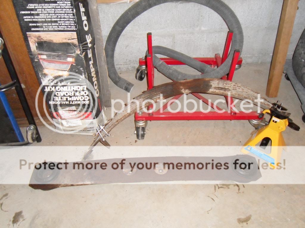

A few years ago a friend went to a glass leaf in the rear of his '66 just to get a better ride. It seems to me that he said that it came out of a mini van. My knowledge on this is zero. I drove the car and it seemed fine and certainly wasn't bone jarring like a '68 that I drove.
The Performance Plus suspension kit replaces just about everything on the car, front and rear.

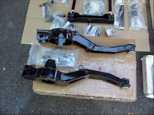

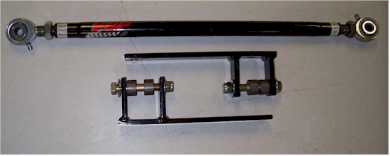

Offset trailing arms. Not part of above kit.
Spreader bar. Not part of above kit.

I am going to replace the rear spring and trailing arms in my 63. Body is untouched and I want to keep it that way. However, I want to use the VB&P monoleaf and offset trailing arms and disc brake conversion. What is the widest 15" wheel that will fit? I like the Vintique Rally wheels.

i'm not 100% sure but i believe a 15x10 is the max with the offset arms and still keep the tire in the fender. manny dasilva can probably tell you for sure and also give you the correct back spacing.
