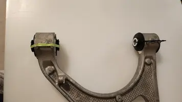

I am going to fab/ install my own pillow ball/spherical bushings. This is not the first vehicle that I had done this to. I am well aware of the pros and cons of such setup.
These AMT Motorsports ones are beautiful and $$$, which is justifiable. It will cost me a fraction of those and they won't as pretty however. It is very time consuming to make. I may combine them with polyurathane bushings to lessen the ride harshness. But the reward is what I am after. It may be too aggressive for most that doesn't track their cars like myself.
A future set of aFe Sway bars will complete the set up. 👌
Finished my first upper rear arm. Reused the stock mount to save me some time.

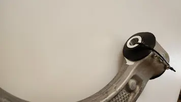

Just completing the bottom arm. I am still debating if I should just replace either the upper or lower instead of both to lessen the vhn.
