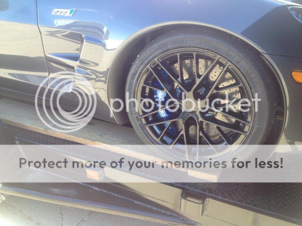

try putting down a 2x10 to drive the front tires on. doing this allowed me to open my door on the ZR1 to get out. My fender flares were 9" high
These pictures were test run pictures... had to move the board farther forward.

I did take of the CF for driving events. I had no issues. I did use wood like you did on the ramps to lessen the angle.
I used a floor jack at the end of the trailer to keep it from tilting to different angles when driving the car on.
Some jack up the trailer at front to lessen the angle... I never had to.
Should be getting a deposit on my trailer today from a Vette guy in Calgary.. almost sold. :)
try the wood.. worked great for me... I am not that old and would hate to crawl through window.. and you would want window up and also put park brake on ( car out of gear )

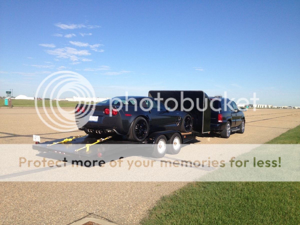

Gentlemen,
And on it zipped! I got out to check it three times and all looked good, lots of clearance at the front under the nose and I had it centered well. So one cargo strap on each tire and I'm set! The door was still a pain and getting the window up and then closing the door was a nuisance but first things first. Hopefully I'll mark where I think the car should be and then to place a 2 x 12 on the left side for lift next time and it looks like Brian was right and the door might clear.
I'm not expecting any better results at the XC itself, my usual stalling, spinning, grinning and hopefully some good video clips to post for you later on.
