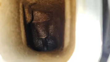

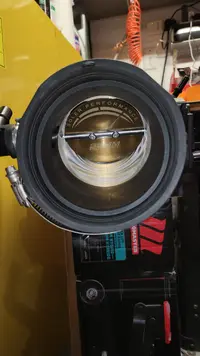

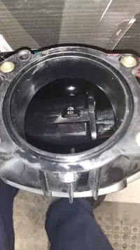

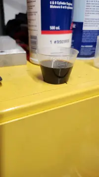

I got around 3/4 ounce of oil in my catch can with around 8k kms. The intake was coated with oil even with it. The only way to solve this problem would be with an addtional injector for the intake with tunning. Something like the C7 and C8 ZR1. 20250913_174307.webp20250913_170256.webp20250913_213901.webp

Is it worth having for that small amount ?
They say for a DI intake engine, which won't burn off the crap, Yes. I won't explain further as I know you can use your AI to tell you why if you aren't already aware. All engines are different though and even the same vehicle's engines may or may not produce the same blow by through the PCV hose. your Perplexesme can likely give some insight.
I'm familiar with them , have never used one. I have seen blow by in old GM V8'S from the 60's even. Happens some in my old Pontiac for example. Just that the amount you mentioned doesn't seem like a lot for the number of miles. Are they recommended or necessary for the LT2 ? Asking for myself, lol............OK. Just researched about the LT2 and it seems that it can't hurt to use one . Now I have to find one on sale with free shipping, lol. Thanks . Although burning off carbon deposits is one of the benefits of using Top Tier fuel it's obviously better to get fewer in the first place.
There is no way to catch all the oil going into your intake, but it does help. You basically would need 2 catcans to be even more efficient from my personal experience on the GM 2.0 Ecotec. I did however modified my Paragon unit to make it more efficient.
The other benefit not to make it a must do but it is all up to each individual preference.
