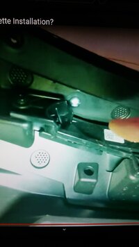

For those to you ( like me) wanting to install a C8 spoiler but no template, This might help.
The first 2 images are from a Utube Frenchusa where he drills holes out with a template in the C8 rear bumper at 12:24 minutes. The third is from a Mid engine corvette form post on installing the high wing spoiler where holes are drilled out already to hold the Z51 spoiler
Here is the rub, Notice holes are drilled middle of a circular intent mark on the underside of the bumper.
For those of you that used a template, do you remember noticing where the holes came through ?
