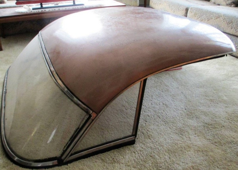

I have an extra clear targa top for the C5 but it does have scratches in it. I purchased another one and sanded, and buffed it. Turned out not too bad.
I have no idea how it would work on a targa top but when my plastic headlight covers get scratched and yellowed, I use 3000 grit wet sand and then mequires scratch remover. Works great on the headlight covers.
That's what I did to my targa top. Started with 600 or 400 to get through the clear coat, then to 1000, then 1500, then 2000 wet sanded all grits, then done a cut compound then a buff compound and topped it off with a couple coats of wax. It was my first time trying anything like it and I thought it turned out pretty good. The top looks like its crackled when looking up through it, but I guess its probably because of its age.
