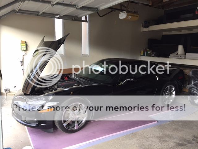

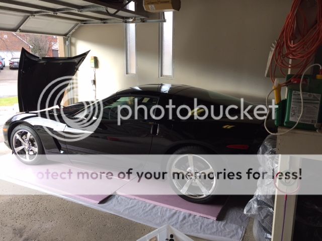

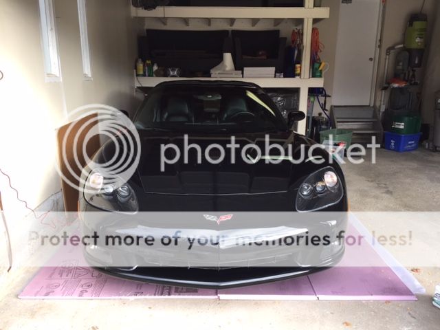

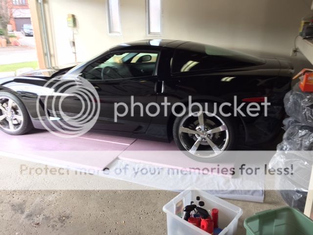

Took advantage of the nice weather over the weekend in TO and put her away for the winter. This is my first Vette, so I followed the protocol laid out by the members in several threads on the forum. Thanks to everyone for sharing great info.
Here is a list I summarized from info on the site - Thanks again
1 - Change Oil
2 - Refresh Hydrolic Clutch fluid using Ranger Protocol
3 - Wash & Wax
4 - Clean interior & Moisturize Leather
5 - Fill tank & add Fuel Stabilizer
6 - Drive for 20 mins - AC on to lubricate the compressor seals
7 - Lay down Vapour Barrier to prevent rust on the undercarriage
8 - Styrofoam (My add - derivative of wood, used no-compression pink board, thought it would be better for the tires to giving some insulation value and softer than the concrete)
9 - Increase Tire Pressure to 40lbs
10 - Release Parking Brake & use Wheel Chocks
11 - Mild to Wild in Off position (as per install instructions)
12 - Steel Wool in Pipes
13 - Dryer Sheets in Cabin
14 -Trickle Charger on the Battery
15- Slightly open Windows
16 - Cover
Count down to spring....
