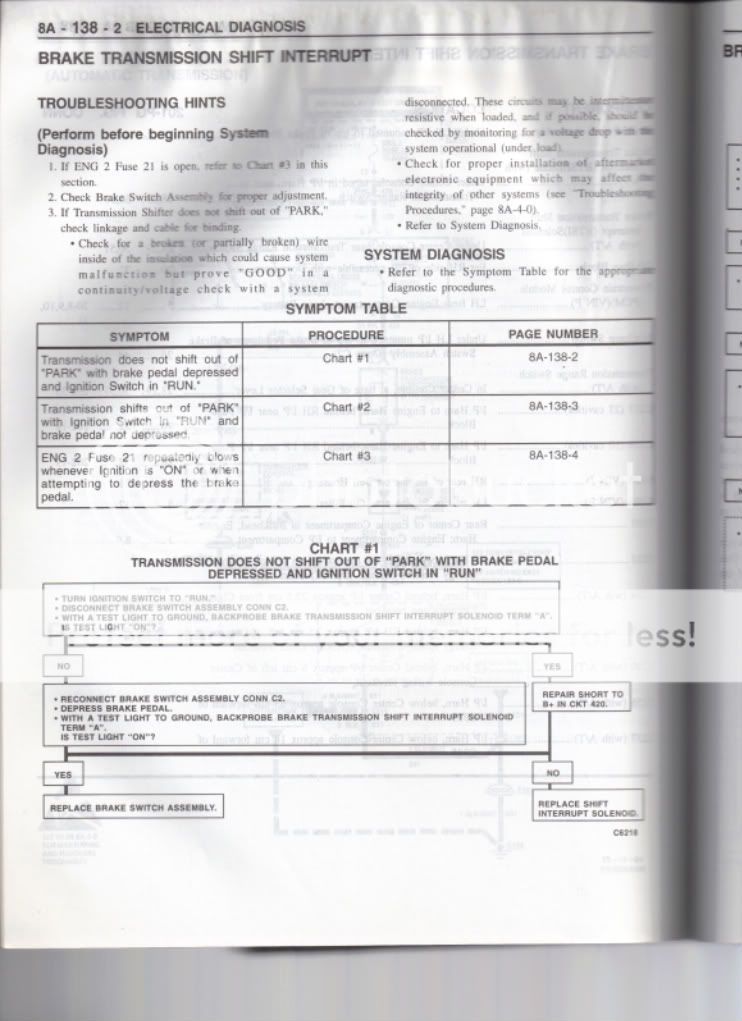

found this file on the net, might help you out.
Let us know how it works out, good luck.
Locked shifter
Thanks for the tip. I followed the info you provided and it was right on the mark. The issue was the shift interrupt solenoid. A pal of mine let me borrow one from his car and my 87 vette shifts as she should.
