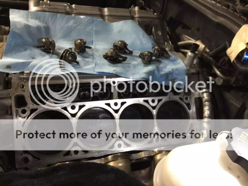

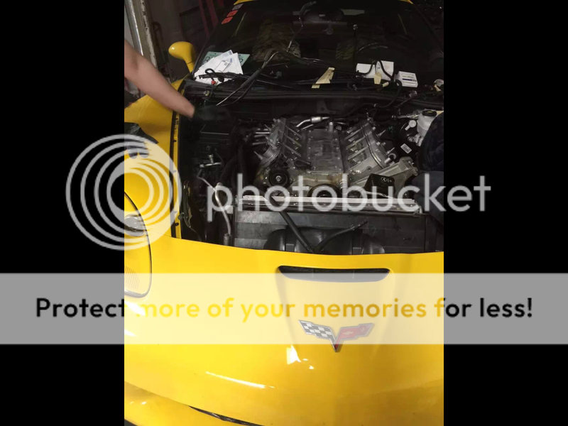

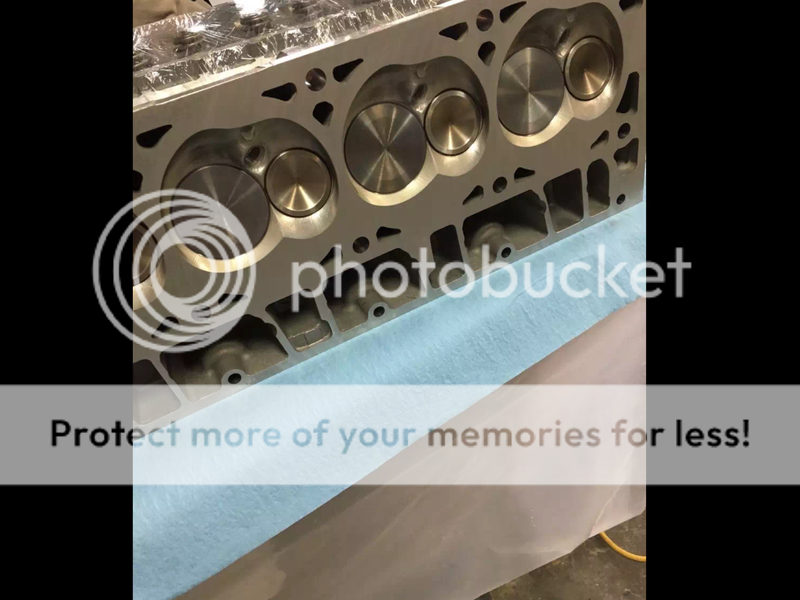

Hi sup. Some updated. I pulled my ls7 heads off on 2016 March myself. Had it sent to Alec machine shop in Vancouver. Remember the car is 2009 but the warranty replacement motor was built Sep 2013 with only 30.000 ish km on motor mileage After their inspection they told me my intake valve guides are more worn out over exhaust side. After bronze guide replacement and re-concentric/re seat the valve seats, decked and bolt back to get it running I notice much quieter valve tick noise from idle to 1800rpm range. After 5500km and 1 track day my valve train remains quiet.

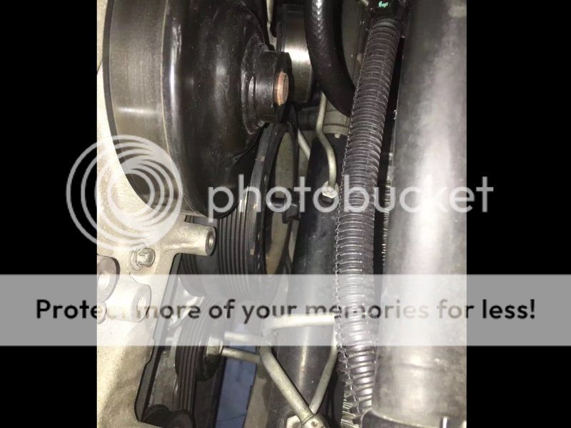

Btw during head re-assemble I noticed my crank pulley bolt back out and completely loose, so I upgrade the crank pulley to 10% under drive ATI super damper and ARP crank bolt torqued to 250lbs and it hasn't move yet after 5500km and 1 track day.
