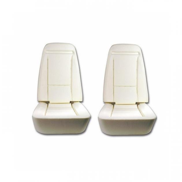

I believe the stuff I need is listed on this page. Jute kit near the top, foam near the bottom of the page
