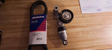

So I decided to pull the Range AFM disabler off and listen for weird sounds and sure enough. While in V4 around 50KM/h and speeding up in V4, clacking sound that goes away when V8 engages, from the internet sounds like its the belt tensioner, will call Carter GM for parts costs and will replace myself, don't seem difficult. Video link below if anyone is thinking of changing it also. Regular C7 link only I believe
  • Informative
Reactions: 1 BAD 9T9
So, it was the Belt tensioner, took about an hour to do it if you go in calm and with the correct size tools and a flashlight to see the bottom bolt
