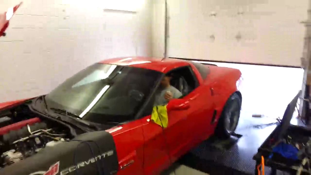

Picked Paul's 2010 Z06 last night with our enclosed .
Loaded on the dyno ready for the pre A&A V3 baseline

How interesting! Is Paul's car currently stock? I've read and been curious about cars running different dyno numbers. I realize that there is some variablity between builds but this might be an opportunity to see if it is true.

438, can't wait to see how I do with a 2006 model.

Gee Manny, that is only 10 to 11% drop from 505........I thought crank to rw was more in the area of 15% difference or more. Is Paul's car stock? Lucky SOB probably can burn 93 too! I'm so jealous with all these pickup trucks around here and no stations stocking anything higher..........
Thus why at a glance 438 made sense to me.

Pauls is completely stock , but the numbers are normal .
Yes you are correct that it is usually a 15% loss , however I think the number lie a bit from GM :D
