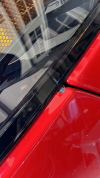

My 2023 C8 Corvette has paint peeling around the left headlight. Car has about 2000 km.

I believe this is happened to other people, how long does the repair take?
The car has PPF on everything from the windshield forward. I believe this front bumper PPF will have to be removed for any work to be done.
I’m not sure who pays for this to be replaced, I didn’t have it installed at the dealership, so I’m guessing I will have to pay for this to be replaced.
Way more than 3-5 on the US forums and C8 Facebook. My friend just got his 2023 3 weeks ago and has the same issue. Technical Service Bulletin:

Thanks sooo much for helping me with this, at first the dealership said I hit something, after I showed them pictures of other cars and agreed to do the repair under warranty.
I was told its my responsibility to remove & replacement of the ppf @ $1300 to me

I’m a retired GM mechanic and should’ve known better and check the clearance around the headlight to the body panels. I don’t know there was a product service bulletin, if I did it would’ve been the first thing I did when I brought the car home in November.
