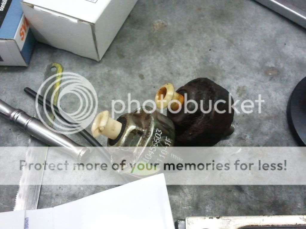

Can you guys tell a difference between these two knock sensors? They both came out of my engine yesterday. One of them was bad but I can't tell which one.
Long story short, water got into where the knock sensor sits on my car. There was also oil in there as the gasket between the block and knock sensor failed.:eek:

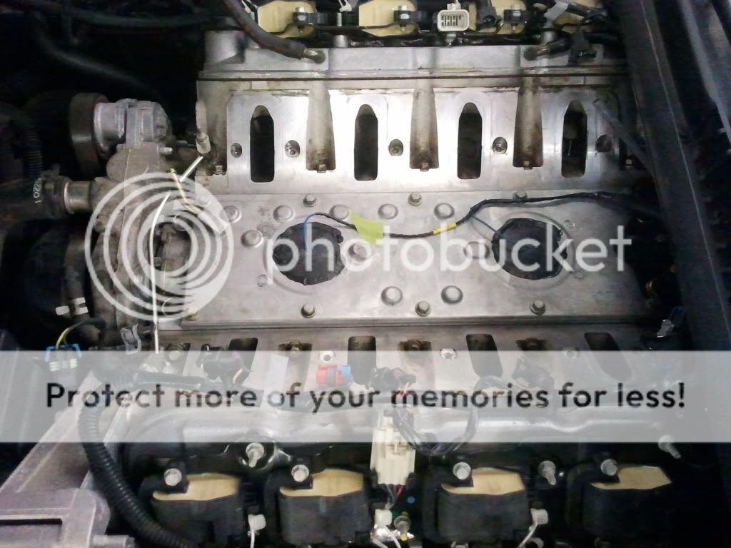

New Valley pan in with knock sensors and gaskets.
Anyway, after a day spent in Regina with Russ K working on the motor, I have a new LS6 intake, valley pan cover, coolant cross over tubes all supplied by our own Manny. I also relocated the PVC valve to reduce the amount of oil going into my intake. Whoo-hoo! The car is back up and running! Anyone in the Regina area with a Corvette, if you are looking for a place to get your car repaired or modded, go see Russ K!

Even apart, these engines are a thing of beauty aren't they....YUMMY.
