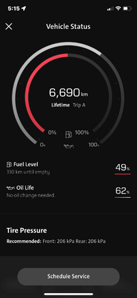

When I got my 2020 C8 at the end of October 2020 it had only 600 kilometres on it when I had to store it for the winter. Break in period calls for 800 kilometres. When spring finally happened and I got it out on the dash it said it was time for an oil change. What the heck? The dealership told me oil changes go by miles or age of the oil. So when it tells me to change it I do it. I still got 62% left before an oil change. So winter isn't all that far off. It will get changed in the spring.
