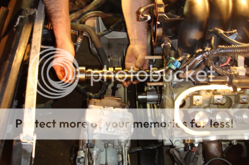

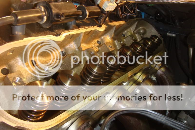

Here is his build :
Melling oil pump
Comp chain
Comp push rods
Comp double spring kit
Comp Cam 226/228 .584/588 114LSA
Edelbrock 2 piece cover
SLP 25% underdrive pulley
top of with some Royal Purple 5W30
How about a few pictures and a little video:
