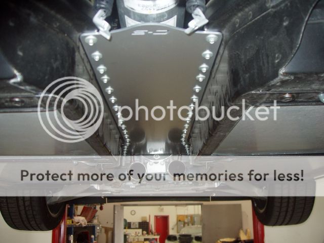

Other than that, the floors/tunnel of the C5 get warm when driving as that is where the exhaust is routed. If you want to keep the interior colder, you can install kits to add insulation.
Get a heat shield from 'Eliteengineering' like I have, big difference.

The tunnel plate and insulation is a great general fix but not your answer if you have a heat control flap that's not closing properly. I'm guessing unless this car is brand new to you, you would have noticed it before if it was ambiant tunnel heat. I'm going with a heat system vacuum tube flap contoller or solenoid or something blocking a flap from closing... Had any mice invasions?
