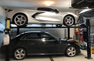

I've got a ProKing 8 4-post lift that works well for a C8 Stingray (photo below). It's made by Lift King out of Calgary but they sell through others in Alberta. However I'd recommend dealing directly with them. Their Edmonton dealer came and looked at my garage and said the lift would have to be bolted onto my garage floor, due to its drainage slope. When the Calgary installers dropped by to look at my garage, they said that wasn't necessary. My garage ceiling is 11' high and I wish it was taller. You'll find the lift dimensions on the Lift King website. You'll need to carefully research what will work in your garage, given not only your garage dimensions but also the vehicles that will be parked on/under the lift. Good luck!
11' is the minimum if you want full extension to work under the car and as Thom said that height includes the garage door opener if mounted above.
I had to cut the loft out of my barn to get the height I wanted. The rear of the barn has a 10' height but it isn't high enough if you want to work under a car standing up.
BTW You can buy garage door opener s that operate from the side and not above.
I had to convert my both my garage door openers (I have a door on either end) to side mounted aka "jack shaft" openers. Not cheap at $500+ each, but freed up a lot of space. I also had to convert the garage door tracks to high-lift tracks so the open garage door is up high. My garage is 11.5 feet high, good for two cars stored on the lift but no trucks or SUVs.
I did similar to gain more ceiling height. For side-mounted motors I purchased Liftmaster 8500's which work well but no doubt there are other brands. Lucky you Mach147 having that extra 6"; every inch counts when trying to get more height to work underneath the 4-post lift. Ideally, I'd like a 13' garage ceiling to have oodles of head room and to park higher vehicles on the lift.

Each to their own but Bendpak and Lift King are in different leagues. I had a lift king but got rid of it after two years and got my Bendpak. The lock release mechanism on the Lift King is “problematic”. Bendpak uses air locks and in 3 years has been issue free.
My Lift King. Notice the external cables.
My Bendpak.
