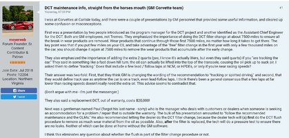

I don't know the price but if you do it at 8000km, you have to do it again at 12000km to make sure all the wear as been done. Refer to the attached post.
I think it's relative. They are saying don't do it at 2000 miles. 8000 kms is plenty of time to get most of the DCCT wear products out of the car IMO.
GM says that to be safe, but it's an average really. I'm planning on getting mine done before the 12000 kms also.
