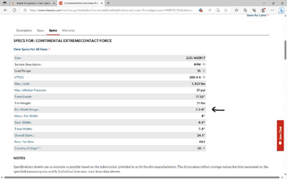

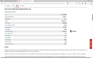

I picked a tire in that 225/40/17 size and 235/50/17:
Basically I would like to mount the 235 size tire on a 9" wheel which is why I'm wondering why all tire manufacturers say max is 8.5" wheel on that size tire. I don't think it's a big deal personally, if we are talking Vette tire sizing a 325/30/19 (rear tire size on C6 Z06, GS) is recommended on a 12" wide max wheel but Apex has no issue mounting it on their 12.5" wheel. I've even done it when I had my Forgeline wheels (325/30/19 PS4S) on a 19x12.5" wheel and didn't have a problem at all.
OK, they are different tires. That certainly can make a difference. A tire width is not 100% accurate it all depends on the profile of that particular tire.
The tread width on 2 tires can be the same, but the bead width can be different depending on the sidewall construction making it suitable for different wheel widths.
All 235/50/17 size tires show the same width range, as are the 225/40/17 size (feel free to check any brand of tire that is available in both those sizes). I did not make a mistake in my postings.
