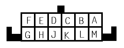

You can pull codes by shorting pins A &B on the ALDL count the flashes
Pin "B" is the diagnostic enable pin and pin "A" is ground. Grounding pin "B" to enable the diagnostic readout of the ECM/PCM.
To recover the codes, short pins "A" and "B" together using a small section of electrical wire or paper clip.
With the ignition turned OFF, short pins "A" and "B" on the ALDL.
Turn IGN ON (but not to RUN).
The "Check Engine" light (early C4s) or "SYS" light (later C4s) will flash a Code 12 (a single flash followed by two flashes) and will repeat three times (Flash (pause) Flash Flash (long pause), Flash (pause) Flash Flash (long pause), Flash (pause) Flash Flash (long pause).
Code 12 is a delimiter or marker code to show where the error code string begins and ends.
After the three Code 12 flashes, you will either get an error code (or codes) or you will get another string of Code 12 flashes if there are no trouble codes stored.
All codes are repeated three times with a long pause between each code group (36 or Flash Flash Flash pause followed by six flashes, repeated three times, folowed by a long pause with any additional codes stored then flashed).
The "Check Engine/System" light on with engine running means the condition(s) are currently present. If the light is not on during RUN operation, the limits were exceeded at some point in time and the event was recorded in memory, but the reading has since returned to the normal operating range.
Remember to remove the shorting device from the connector after you have read the codes.
