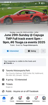

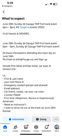

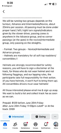

There is the info about the event. I’m going to be taking it very easy as it’s my first time. I already have the extra 2 quarts for dct. Not gunna touch the camber unless I go to Mosport. As 99% of my driving is commute.

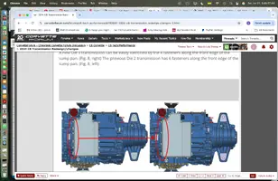

Are you certain about the extra 2 litres for the transmission? It was changed late '23 ( July 17), vin 7263. Tag on transmission should be M1M. The revised transmission doesn't need the extra fluid. The new transmission has 4 bolts along the front of the sump pan

Yes you are right… I double checked with dealer 2 quarts already in. They said z06 already has.
