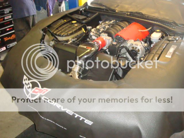

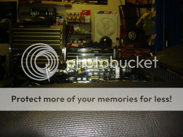

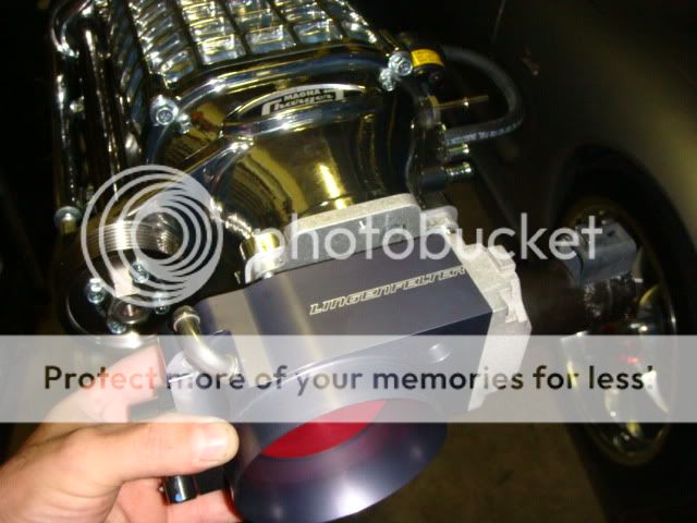

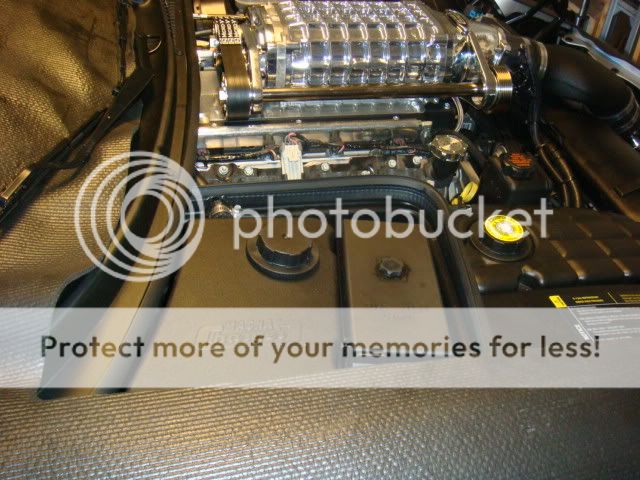

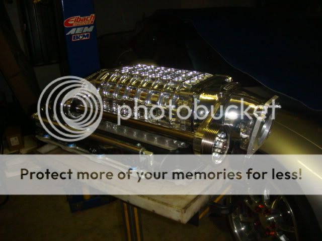

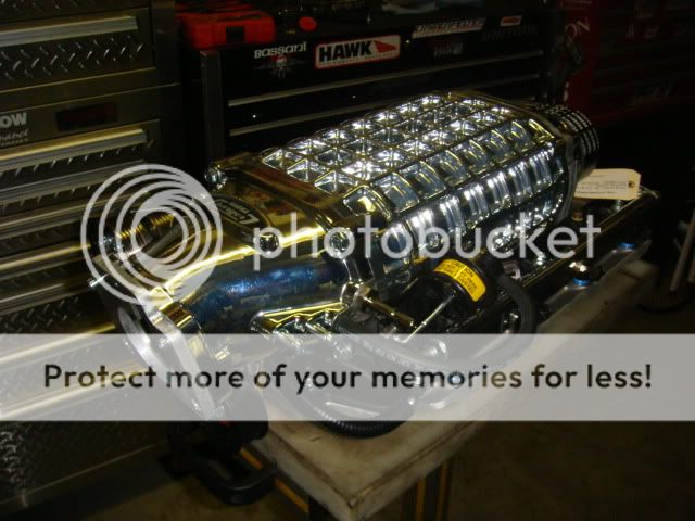

As promissed here are a few teaser pictures .
This says it all ............pure sex
Lingenfelter 90mm TB with LS1 electronics
Here is a small list of the build:
TVS2300 fully chromed / 3.1 pulley
ECP custom blower cam
Comp valve train / 921 springs /Comp 7.4 pushrods / Comp truion's
ARP crank bolt
ATI Super Damper
JP Double roller chain
ECP Custom FRC covers ( first of their kind for the TVS2300)
RK Sport blower hood
Should be real NASTY :D

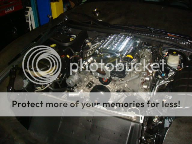

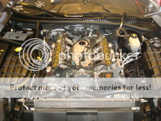

Day 1 results :
Car is dropped off around 1:30pm , and away we go .
Corvette Club present
Hood off and gone , let get this puppy boosted
Top end tear down complete
Old cam out
We need to fill that cavity, think I have just the thing
Cam spec sheet
JP double roller chain installed
New pulley installed and pinned
Valve train all in , and blower on to crown our day
Blower side view , this thing is massive
Ok , so not a bads days work so far.

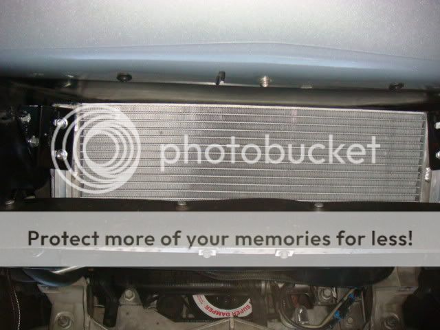

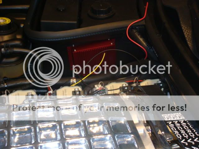

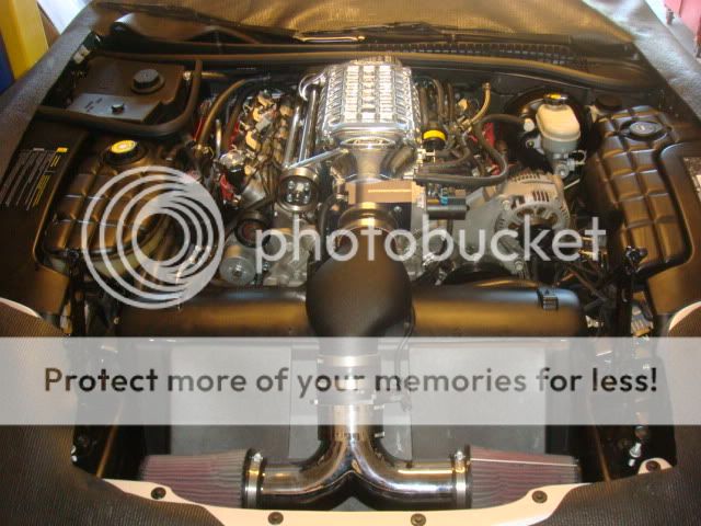

Ok , here is todays up-date , after being away for a few days .
Almost there , just some wiring,add fluids and light it up :D
Intercooler in.
Lookin good here
Should have some video tomorrow , still waiting on the ARH headers .
