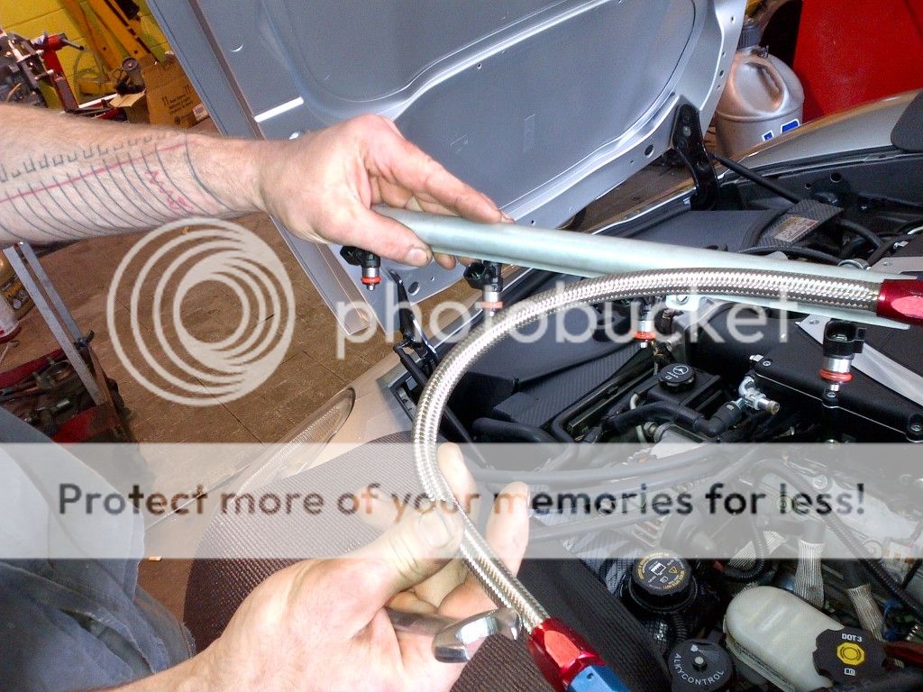

I spent the day yesterday doing a few upgrades. We switched to ID850 injectors, 3.25 pulley and modified the fuel line to feed the rails properly from the rear to prevent any possiblilty of starving the last cylinders to get fuel in the stock setup.
Thanks to my man Seth at Federal for many hours spent to get the tuning right with great power and my priority, safety for the motor. We got 619 rwhp and 650 lbs of torque but backed it off a bit in the end to be safe. Idle and driveability are as good as stock. Now if I can figure out the shift points with my 17" tires I should get some great runs at the track this summer!
