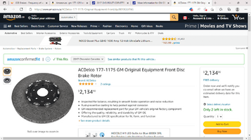

If you're looking to replace your front CCB rotors or want to grab a pair at a good price, Amazon Canada has them at half price compared to GM right now. I priced them at a dealer this week at $3600/rotor jobber cost...$4300 ea to the guy off the street. $1840 ea on Amazon.
Link on Amazon for these CCB rotors??
edit: just checked on A.ca
  • ACDelco 177-1175 GM Original Equipment Front Disc Brake Rotor, Rotors - Amazon Canada and 4 mo...png
If you search under 177-1120 they'll come up. Lol I'm not tech savvy enough to post a link.
GM also has a 177-1175 front rotor which is interchangeable. I'm led to believe the only difference between the two is the set screw that holds the rotor on the hub which isn't a necessity.
