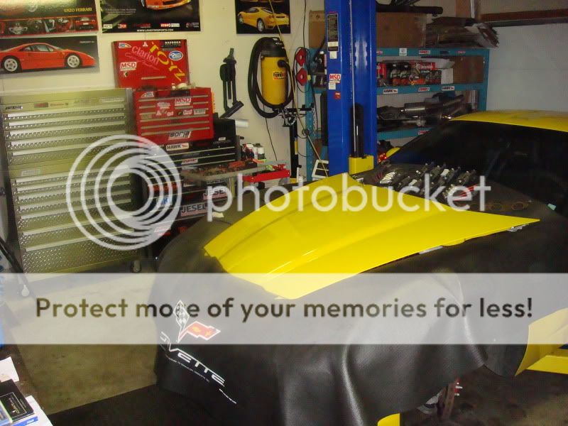

What's this ?
If your answer was "AN LS7 ABOUT TO BE CRAMED WITH A BIG STICK"
You were right :rofl:
Here are the parts :
Some LG Pro's
B&B's
Valve train extraction
The Rocker's
Now he should be able to live up this plate.........:D
More to come as this build comes together .
