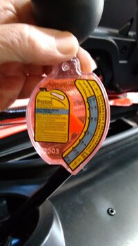

Here are some pics of coolant measurements. Note this 50/50 mixture scale. C8 has a 40/60 mixture.
Readings seem ok to me. At least the needle is in the middle.
View attachment 80904 View attachment 80905
That reading is very far away from being OK.
Store it in an unheated garage in Alberta in the winter at -40C and crack your block!
Hope your toy gauge is way off! I do not believe GM would skimp on coolant.....
Here is a new pic I took which show a -23 C per Corvette 40/60 mix spec as of today. It must be at required fill level of fluid and held perfectly level.
Also for those of you who can read a graph which shows temp vs mixture( from Corvette Forums).
I really cant confirm that this reading applies across Canada since nobody has uploaded their readings.
As for my trusty Prestone toy , I had it for15 years checking my boat and other cars and nothing froze.
Amazon has it for $9.95 now. I bought mine for 99 cents then.
Next oil change and I`ll have them check again.
Note this is in Pickering Ontario. Best you confirm the ratio might be changed in your province to adjust for weather
