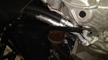

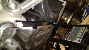

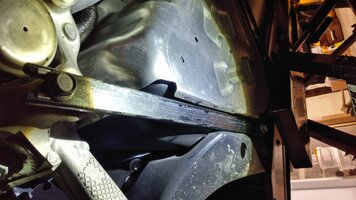

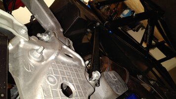

Not a big deal pulling the alum braces off and install these but I did run into an issue with 1 rear composite brace. The area where the bolt go through the metal U clip there is a high spot in the U section that was just enough to prevent the bolt from cleanly going through the brace and threading into the rear cross member. Of course if you man handle it and impact the crap out of the bolt it will go in but I don't do things like that. I ended up getting some sand paper and removing the high spot in that area (took quite a bit of sanding) until the bolt fits through freely and threads into the X member all the way in by hand. The other 3 braces had no issue so chalk that up to manufacturing tolerances (even on a Chevy Performance part). I expected all 4 to go in no issue but I guess as with most afkt items you install on your car a hiccup free install is the exception and not the norm.
Here are some pics and I still have to do a video where I will explain that issue in more detail with visuals later. I'm happy with how they fit and should work like the factory braces and lighter to boot.
