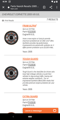

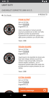

Based on a quick Fram search yes.....

The change from the 13/16-16TPI took place in the 2007 (Last of the LS2) model year when they went to the 22mmX1.5mm thread pitch. Another difference that I noticed looking in the Fram catalog filter specs is that it shows the filter bypass valve opening pressure for the XG10060 as 9-15PSI while the XG3506 list the bypass valve setting as NONE so I assume it means that the XG3506 doesn't have a filter bypass valve in it. I found this out shortly after we acquired our 2007 in 2016 and I did my first oil change. I found the XG3506 filters that are normally about $14 on sale for $7 so bought 6 of them and had to take them back.
