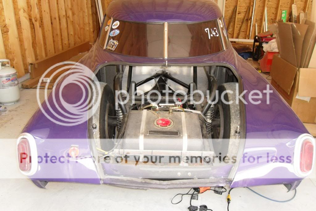

Just some pix of the Six link..hope they turn out.:)
